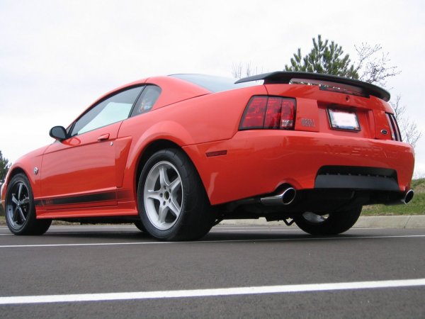

As a point of reference I use 275/40/17 M/T DRs on 17x9 Cobra replica wheels on my Mach.
I have . .
Welded Subframes
Welded Rear Strut Tower Brace
MM Adjustable LCA
MM 4-Bolt CC Plates
MM K-Member Brace
Vogtland Springs
I have pulled a best 1.77 60ft and a 1/4 mile best of 12.97 @ 106.6 with a 1.87 60ft.
I have a set of 4.10s waiting to go in . . . at some point but not until I have a 31 Spline carrier and 31 axles.
I run about 3-5 times a year (with ~4 runs per outing).

They're real good numbers Evil. I wish I could get my 60 foot under 2. maybe with a little more work.
Out of curiosity, what height front tire are use using with the 40's on the back? I was thinking of going with the 275/40 DRs but I would still be running the 245/45s up front and I don't know how well that would work.

Yeah, what CircuitBreaker stated . . . .
I usually run my stock Mach 1 wheels/tires when I go to the strip, but I have run my 18x9s (265/35/18, which is still shorter than a 275/40/17) in the front as well . . . though 18x9s weigh more.
