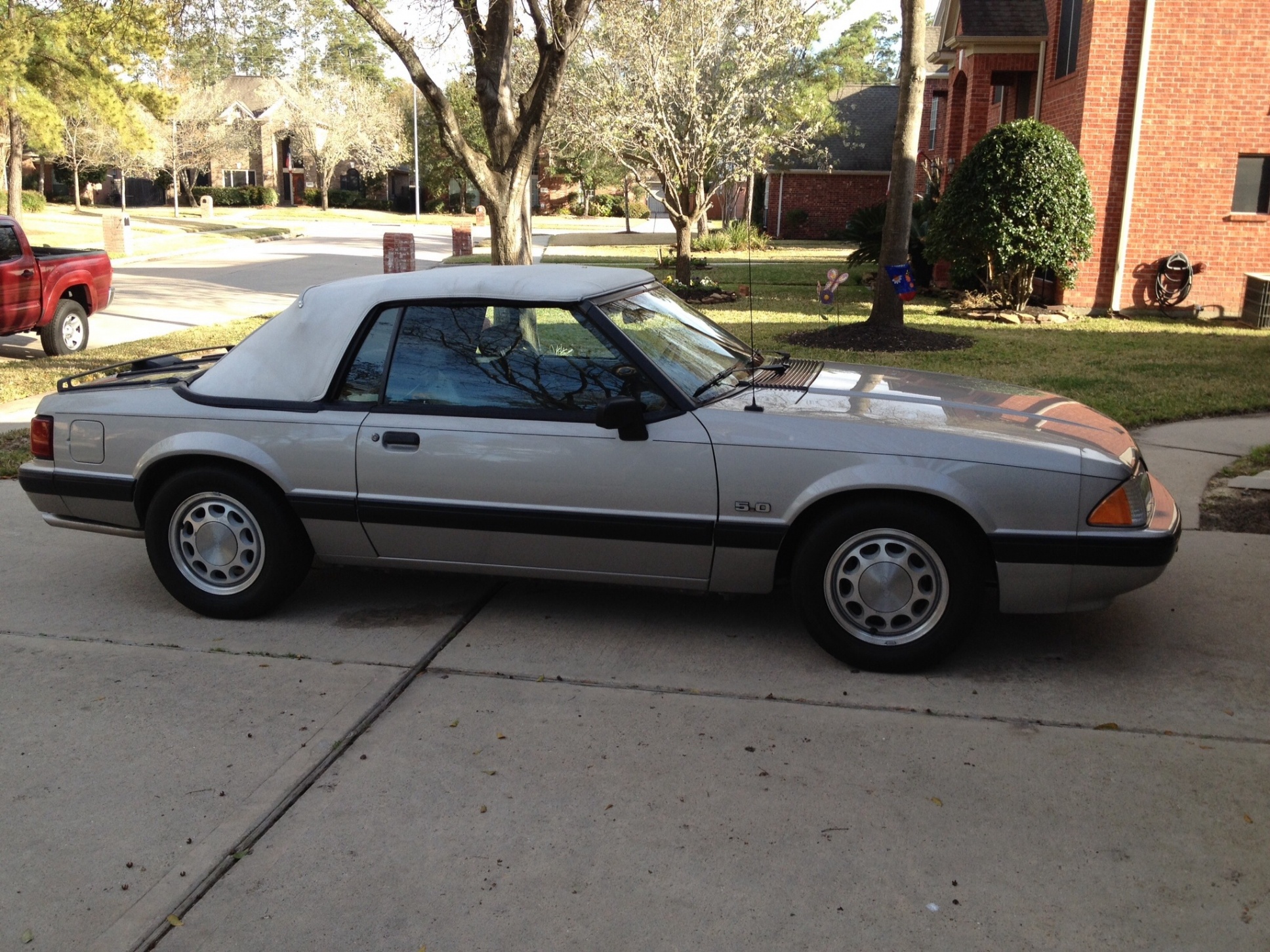

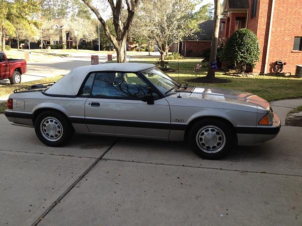

Beautiful car, I have one just like it in light titanium. I've been thinking about getting some pony wheels, mine has the factory ten holes. I like the ponies a lot on your car.

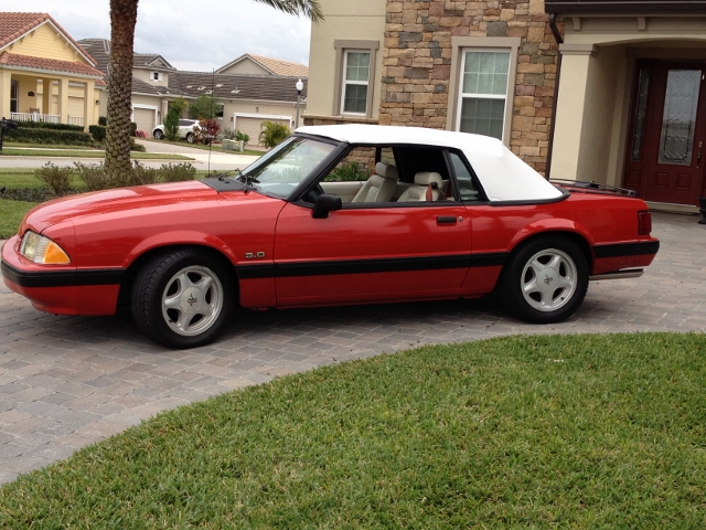

I just finished putting on Ford Racing B springs, along with KYB Gas-A-Just shocks and struts. Made a big difference in the ride quality.

Chris your car looks great. The previous owner replaced the 10 hole rims with pony rims a while ago on my car. I have always liked these wheels and will probably keep them for a while. They would look great on your car.
