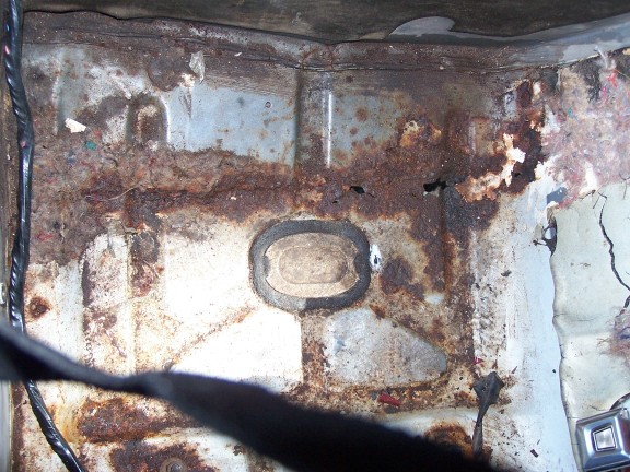

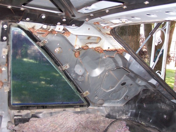

Here's some pictures, I'm going to be in AL this next week, anyone got a nice Southern roller for sale cheap? Problem is that I have owned this car since '92, its my first Fox, and my kids have all ridden in it and now want it, so there is some sentimental value in it, but then again, how safe would it be for them in an accident if it was repaired?

Well if the car has sentimental value and you want to keep that car then replace the floor pans and install good subframe connectors with a jacking rail/matrix brace kit. Clean up the welds where they are rust and if there is any area they missed...weld it up and paint everything when done. The subframes and bracing will help give more strength to the car than it had originally and should be safe. But that is a pretty big project....so it's up to you.

Yea, I know, its a big project. The car already has Kenny Brown super-subs in it, installed a few years ago. Was planning on the jacking rails to stiffen the rockers, and a 'cage to tie it all together. But, I've also found an '83 Capri that I'm gonna look at up here, and I'll be looking while I'm in 'bama too.
