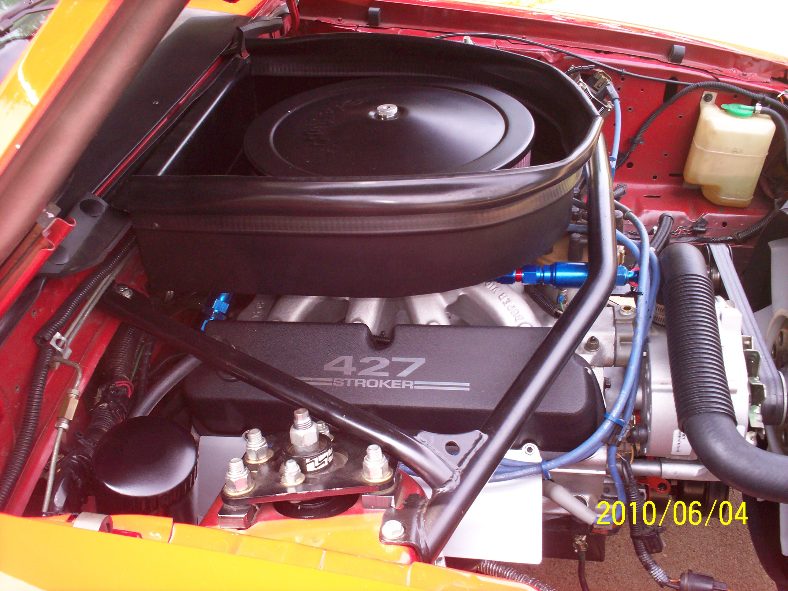

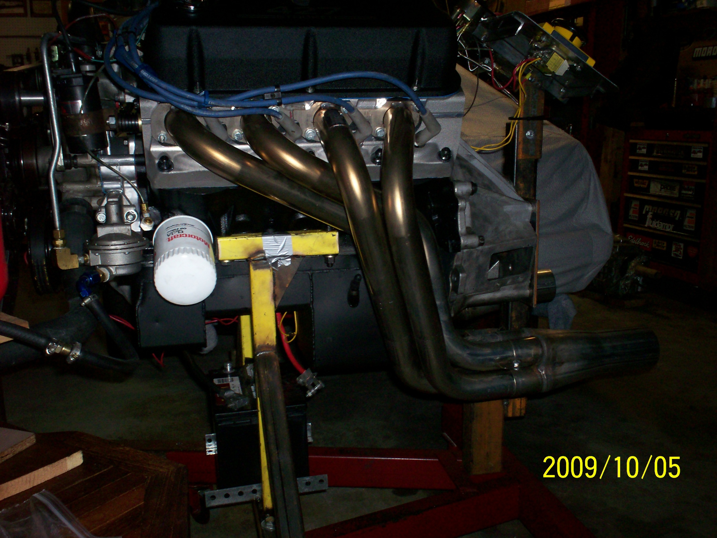

[QUOTE=Tirefryer;6093200]Hay everyone out there in mustang land im looking to drop a 351 in my 93. Just wondering winsor or clevland witch is the better power plant for my fox. Anyone have a thought....[/QUOTE
351W based swaps fit very well! We slid this build in with the headers installed!
