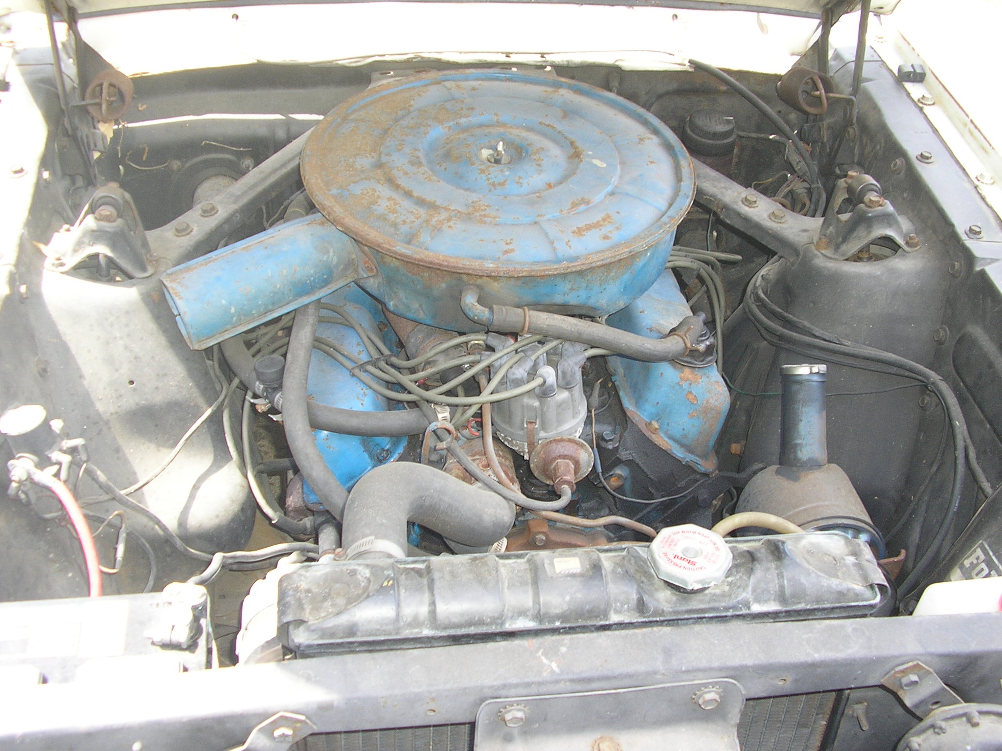

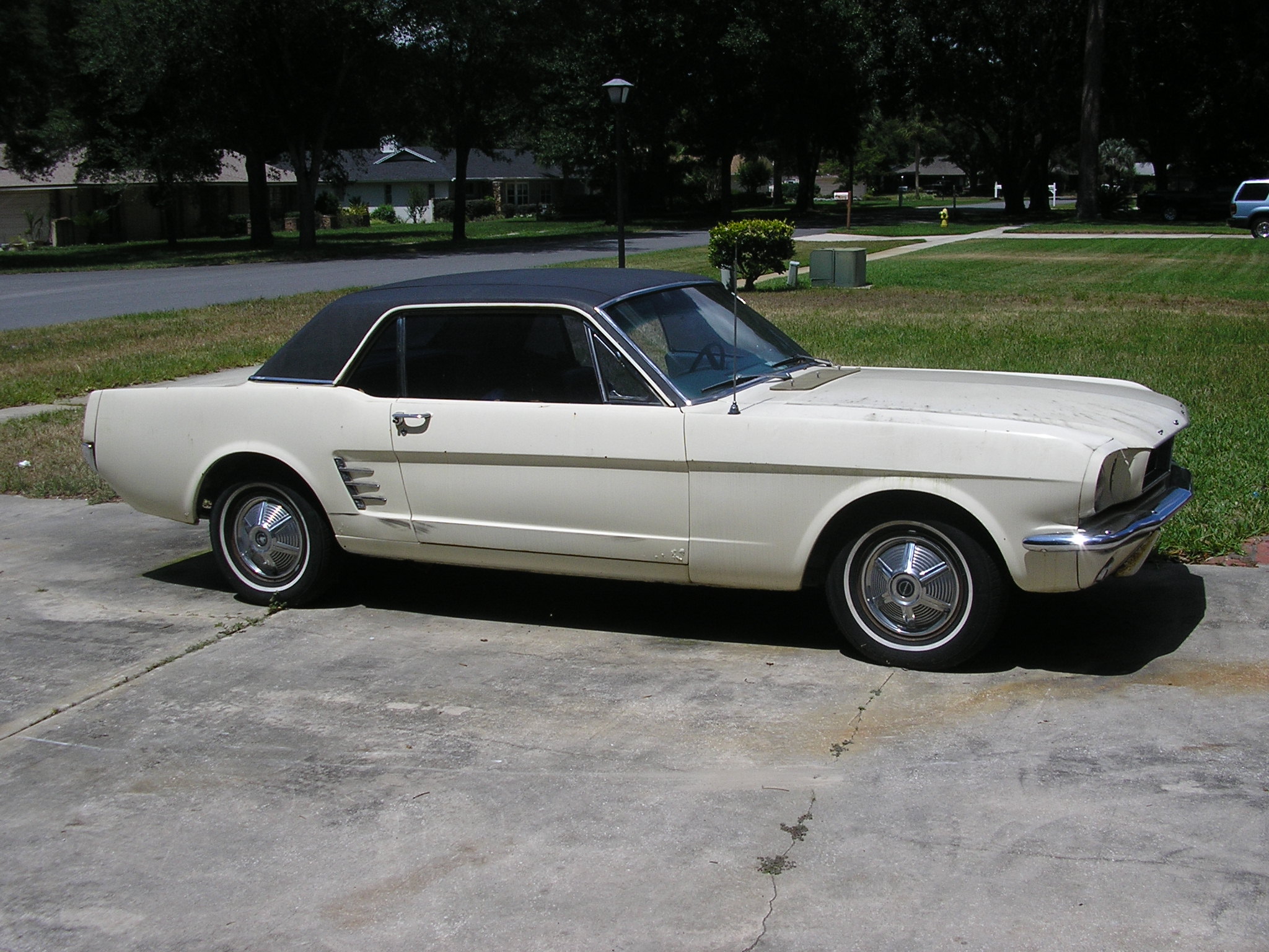

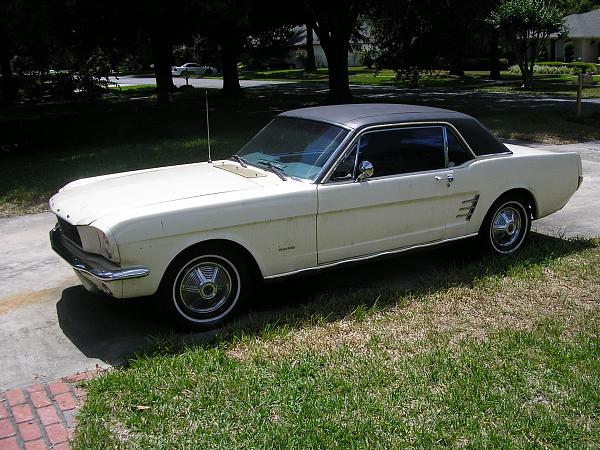

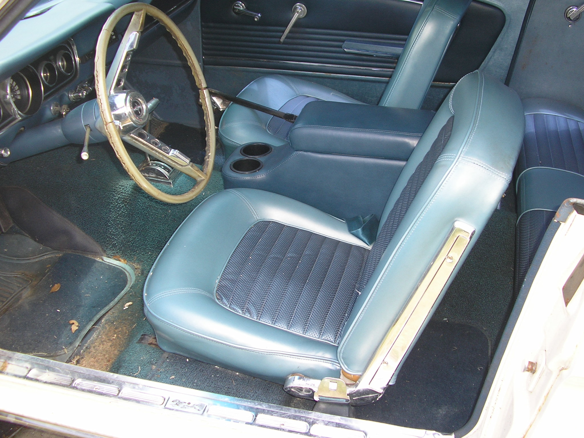

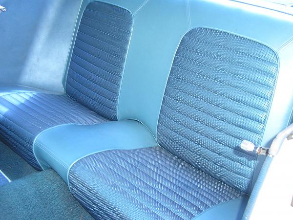

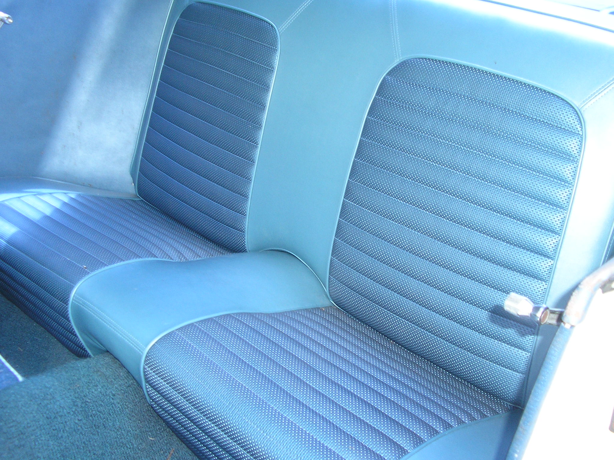

Before telling you what I am paying, I want you to tell me what you think I should pay.
Its a 1966 Mustang non gt coupe. It was originally an A code 200 hp 289 car. It has the original c4 auto with a 2.80 rear. It has the basic interior in blue. It was originally and still is Wimbeldon White with a black vinyl top. It has the original hubs. Currently has a 302 in it but there is a 289 that comes with the car that is bored with an intake and 4 barrel carb. No heads are on that engine. It was originally a two barrel car and had/still has power steering. All gauges, accessories, and heater work. It was a non ac car. The car needs paint, but subframe looks good with some surface rust around the drivers side seat holes where it doesn't have any plugs. The cowl has a small leak and the buckets need to be replaced. Some surface rust on the channels and major rust on the drain holes on the rear quarter. Rear trunk is clean as a whistle and one fender has been replaced. No sign of an accident. Needs a new steering wheel and the interior needs to be freshened. There is a tear in the drivers seat and the drivers carpet needs to be replaced from the drip. Shock towers look good and the car drives and brakes well. Car comes with both engines. I am thinking about painting it brittney blue. I have attached some pics for your review. Let me know what you think.

The good news is I have a running 302 in it now so the car drives fine until I have the 289 built.

I'd guess about 2K myself, given the rust issues... maybe 3, if I was really feeling in the 'gotta havit' mode.
I'd really have to be having a good look under the dash, under the car, etc. But the bubbles in the door outside are not a great sign. Rust is my biggest concern... and I *hate* those stupid cowl covers. Hate. There are easier ways to fix that problem... it's called Por15 paint, Por15 putty, and tophats inserts. Worked great, no more issues... basically rebuilt the cowls from the inside... and easily added on if needed.
I am well aware of unwelding the cowl and repairing correctly... which is why I'm totally against the cowl cover. Fixing the problem THAT leaves behind in my opinion is worse.. those poor little slats...
Still, it's not a bad starting point, I'm sure you're gonna have a really good looker when you're done!
