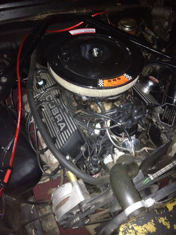

Why does my GT die out at a stoplight? Or just out of nowhere. Then it becomes very difficult to start up again.
Carb was rebuilt 6 months ago
Full Tune Up.
Plugs + Wires changed
It will run perfectly until I start driving it. Then out if nowhere it'll die out. I want to drive it but I don't trust it yet. I want it to be reliable. Any help is greatly appreciated.
