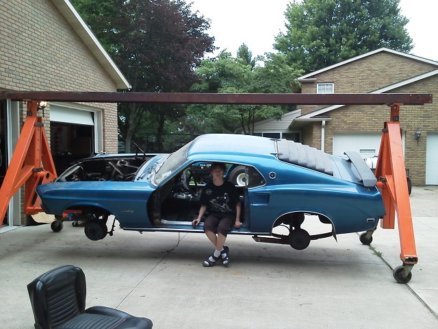

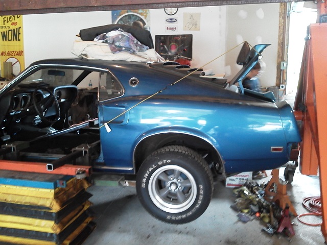

after a 29 year garage nap, FINALLY getting STARTED on the 69...
Friday we pulled a bunch of stuff off, finished fabbing the mounts, got her in the air. Gotta start somewhere

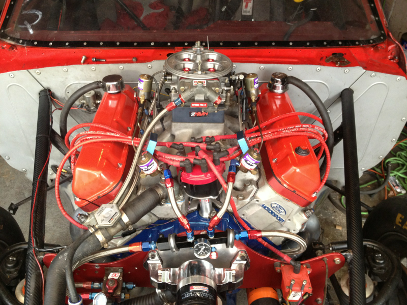

I pulled the motor in 84 after some punk kids out throwing beer bottles at oncoming cars screwed it all up, was planning on just dropping in the 429 and repairing/repainting the damage (windshield, pillar, lots of chipped up paint) and starting to show some rot- drivers quarter, door bottoms are shot, one front frame rail and torque box for sure, and surely lots more lurking under the heavy heavy heavy undercoating... all in all, the near 3 decades sitting in a dry garage havent degraded it too much, a few scuffs from a long ago busted garage door spring, and a little dent I added when my cherry picker swung into the door when I was assembling my bridgeport- DOH! doors were shot anyways...
plan is RRS-ish coilover front struts, lose the towers, adapt 2005+ controls to the 429- cam advance and all...will require new front cover with dual water pumps, but think it would give needed room and look cool...time will tell if it gets that far...first theres like 3/8" of undercoating to strip, and lots of rot most likely...needed rotisserie as I did our galaxie on just stands about 10 yrs ago, and still feel it in my back/knees...crawling around under a car is a rough way to spend a summer, hopefully this will be a heck of a lot easier...

believe me, a set of Kaase's heads is at top of my wishlist... if I hit the lotto maybe, otherwise, probably unlikely...
Jon Kaase is a hero to many BBF fans, he singlehandedly resurrected what I believe to be the coolest powerplant ever... well the 427 SOHC and the 3V 427 'Calliope' might be debatable in that regard, I'd still take the Boss
the Calliope had the dual water pumps, kinda what got me thinking about the extra room for a hydraulic cam phaser if that approach were taken...looks cool and shortens the motor a couple inches... was reading recently that when either H-M or Arias went under, the original core boxes for casting the calliope heads were included- unlikely, but someday that engine might reappear too, long as the old core boxes didnt wind up in the trash... heres a pic of a Calliope 427- one of only 2 or 3 built, the dual pumps really shorten up the front of the motor...

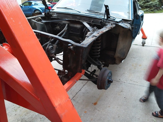

got the front suspension off, poked holes thru the top of the frame rails on both sides...I'd thought the passenger side was fine, but dummy me never realized the bathtub like area under the upper control arm was so deep...had a inch of mud in there on both sides, dug it out and started poking, screwdriver went thru like toiletpaper...luckily there was a thin layer of metal still there, so the whole rail wasnt full of road grime and rust... had it been Id be afraid of it breaking on the rotisserie.
pulled the rearend the night before last, surprisingly, think the floor is gonna be ok...only area with any rust was surface, poking around it looks real solid. funny thing, the old parking brake cables are still smooth as silk...dont see that often on a car this old

go501green- looks like a nice find you got there be sure to check that area I pictured a couple posts up, the area uner the upper A-arms is kinda hard to see, likely harder to clean...i was surprised to find rot there on both sides of mine under a ton of still wet cosmoline undercoating put on when the car was new...sat inside the last 29 years/ 61,000 miles. guessing thats a kinda common place for dirt to collect...
