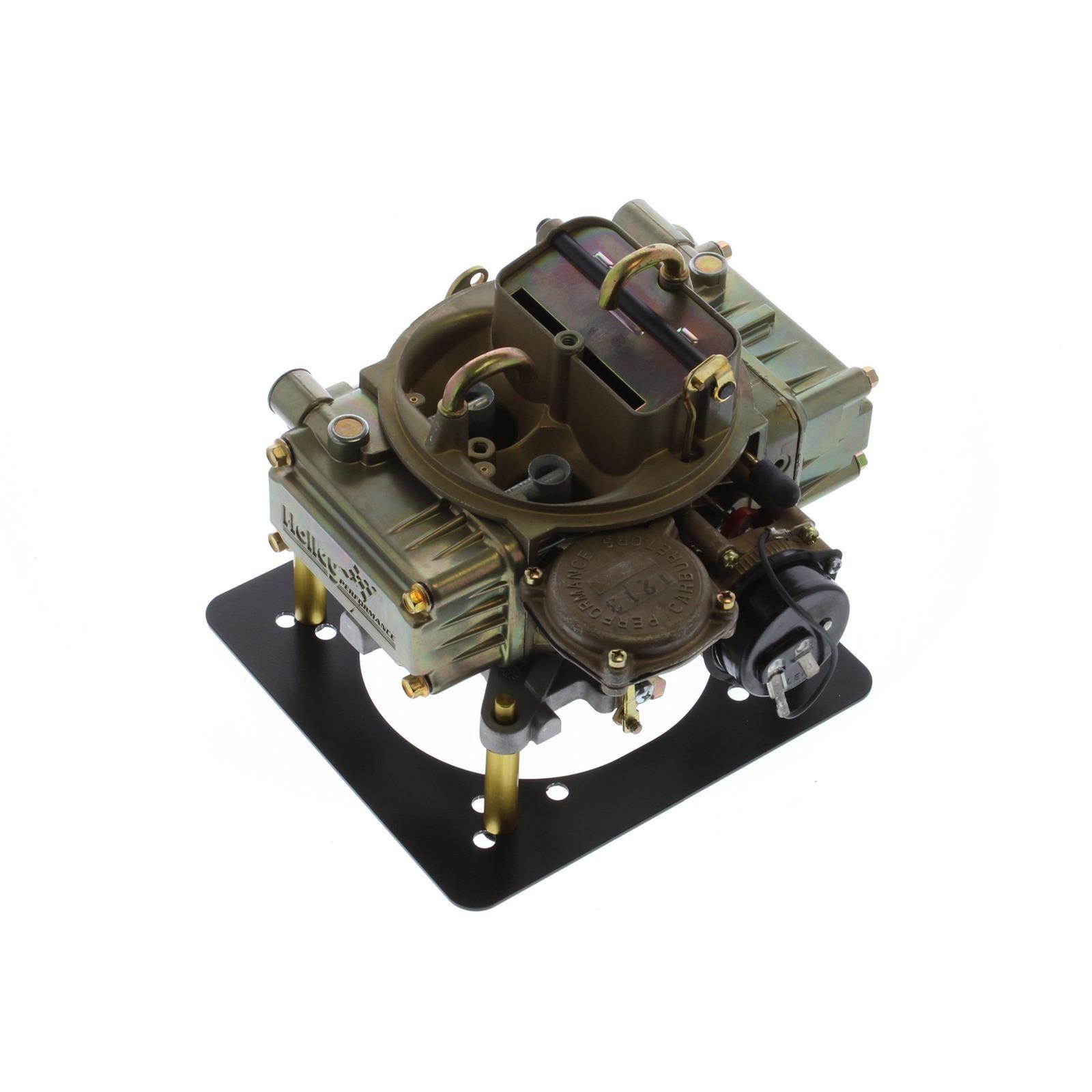

A Quick Look At Some of My Old Holleys Laying Around And A Factory Holley Spreadbore Has Much Shorter Factory Vents. the Old Double Pumper I Ran on My 440 Mopar Had Them Removed By Somebody Else. Never Had Issues With It! But That is Just Me! Ever Seen The Vents on a Marine Carb? Anyhoo Your Choices Are in Reality. A Hole in The Hood With a Scoop. Shorten Vent Tubes. Lower Height Spacer Plate, Change Intake Manifold Or Tweaking Engine Mounts To Drop a Bit or Mixture of More Than One.
Looking At Installed Pic Have You Already Removed Plate Vs Strap Pic? Hard To Tell!
Would an Oval Filter Fit in Scoop Recess Better. A Pic From The Top With Scoop Removed Might Be The Tell!

Thanks for the fast reply KC…. We definitely removed the spacer first thing. Thought about cutting the vent tubes down but my engine guy doesn’t want to mod a brand new carb. My best friend, serious motor head, said to just go EFI….. but since I was 16 yo, I’ve always dreamed of having a mustang with a Holley 750 DP…😆😆. Back in the 70’s that meant serious business!!! I love my new power plant and drive train…. It was built by SPEC Racing in Huntingburg, Indiana where we live and it’s beautiful, sounds beastly and I want to keep it as built and tuned on the dyno.
im looking more at maybe modifying a bigger “Boss” style scoop to add the turn indicators, etc. would be relatively cheap and I can actually do some fiberglass/body work. I was a licensed aircraft mechanic before I retired so it’s not completely foreign to me and I think it may be fairly straight forward. Do you know of any aftermarket shops that sell the larger scoops with turn indicators? I’d rather buy one than make one but either way….

Hi KC - read through the vent tube thread on the carb. I’m thinking that since I’ve got a filter top, that clearance to a standard solid cleaner top won’t be an issue and it should work just fine as an interim solution. It should still be able to vent to equalize as intended. Or am I stupid?😆😆. Thanks Mike
