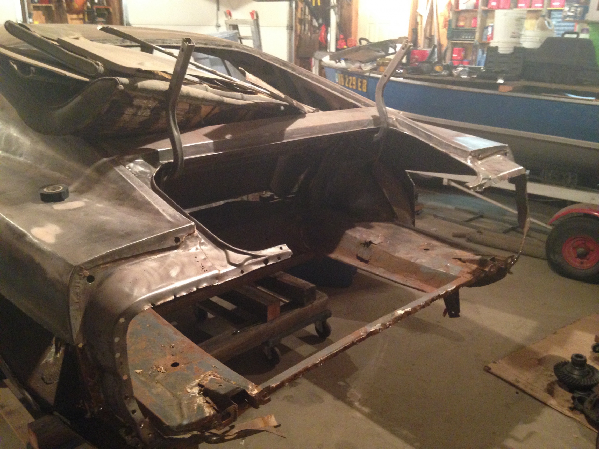

I've posted a few pictures of the progress I have made so far, but thought I'd put everything into one place and update as I go.
Bought the car in March 2013 after I traded in my college crotch rocket in Omaha. I am the 4th known owner of the car. Previous 2 owners bought it with the same intention as mine to restore the car. Neither of them worked on it at all, it just sat. It came with plates from Texas with the last registration stickers reading 1993. That's really all I know about the history of it. Came with the 200 6 cylinder engine and 3 speed manual. Those are both long gone.
I don't have any pictures when I first bought it. Old phone was destroyed and couldn't retrieve any photos. I have been working on it as much as I can when I can. It is a long process for sure.
Attached Thumbnails 1970 Fastback Build Thread-001.jpg   1970 Fastback Build Thread-002.jpg   1970 Fastback Build Thread-003.jpg   1970 Fastback Build Thread-005.jpg   1970 Fastback Build Thread-006.jpg

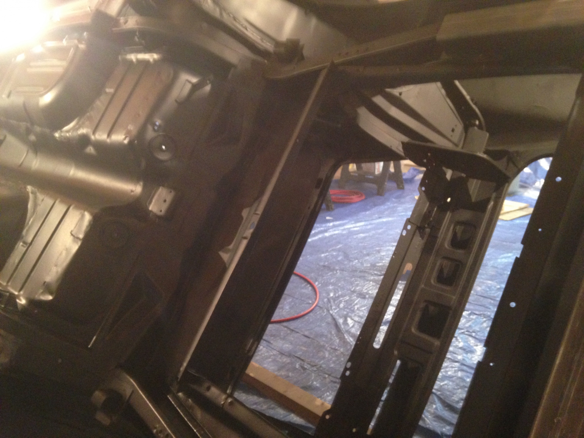

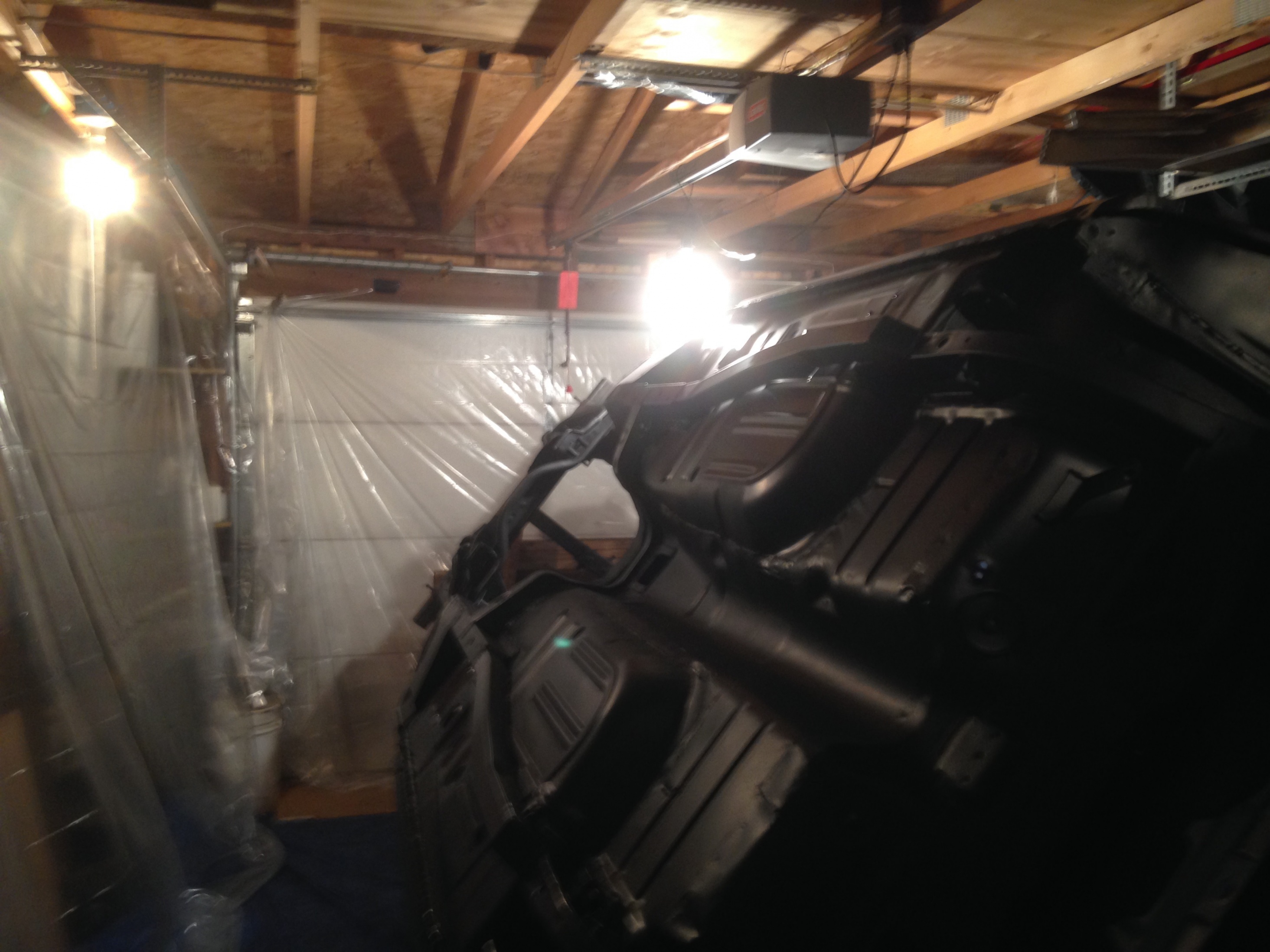

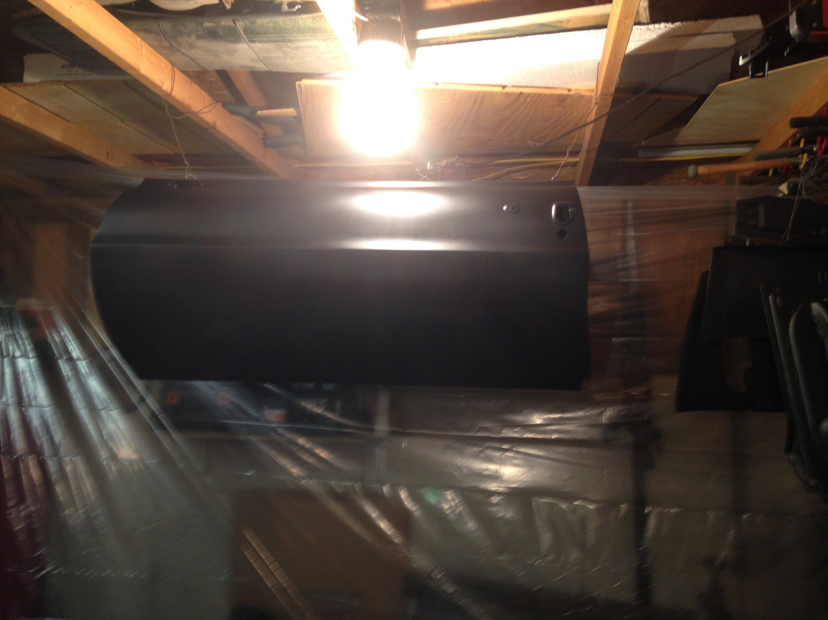

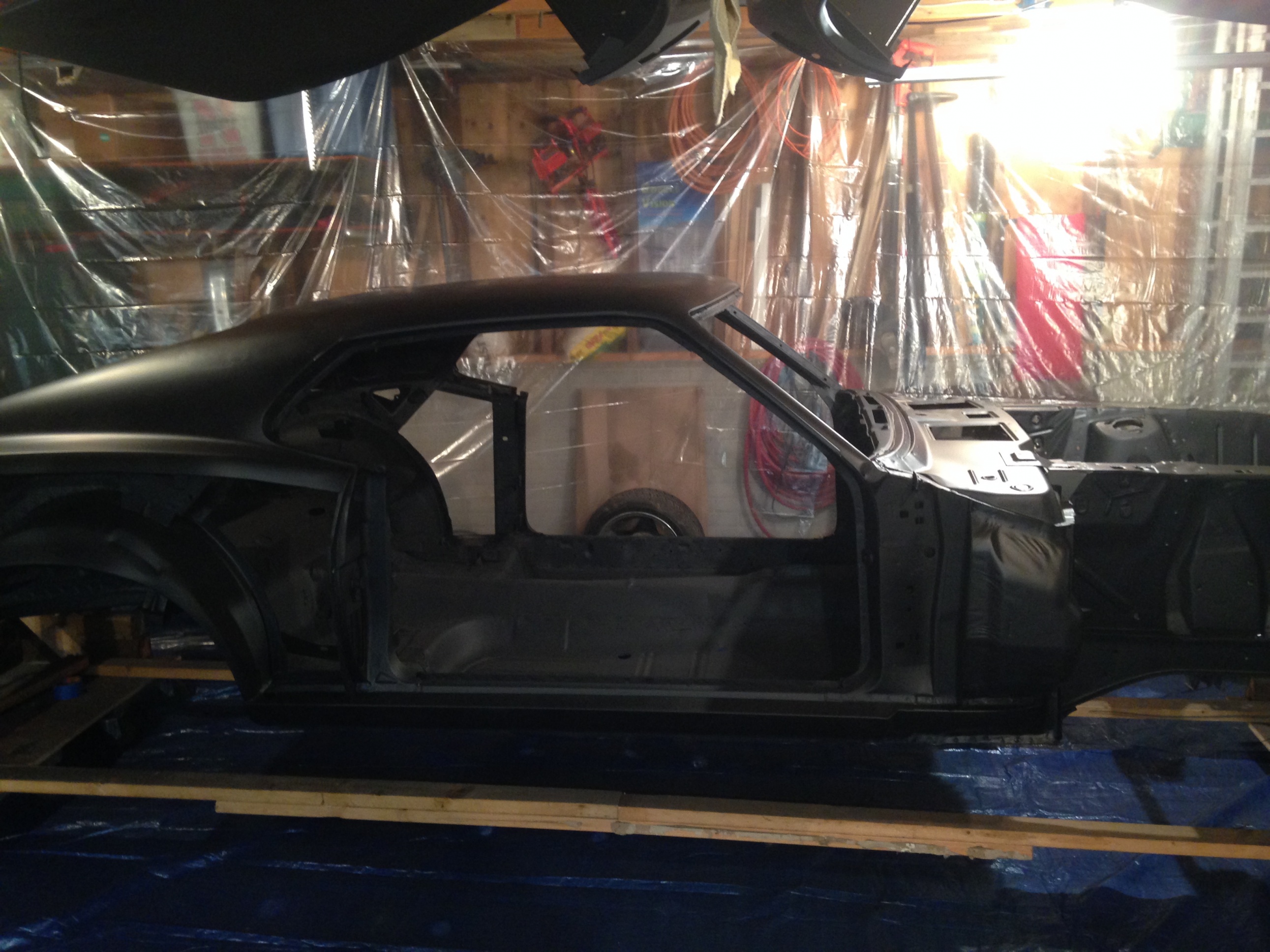

Paint

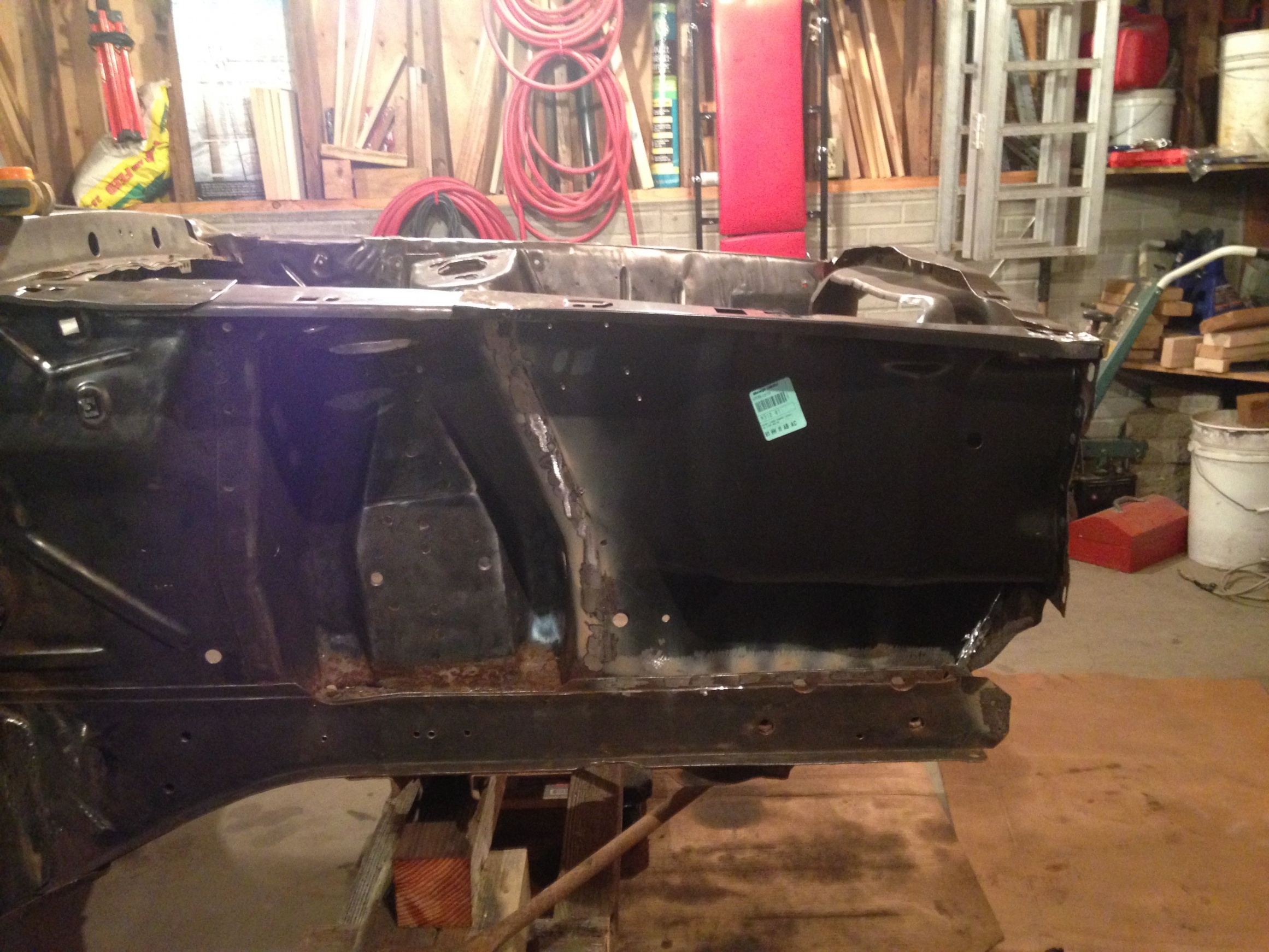

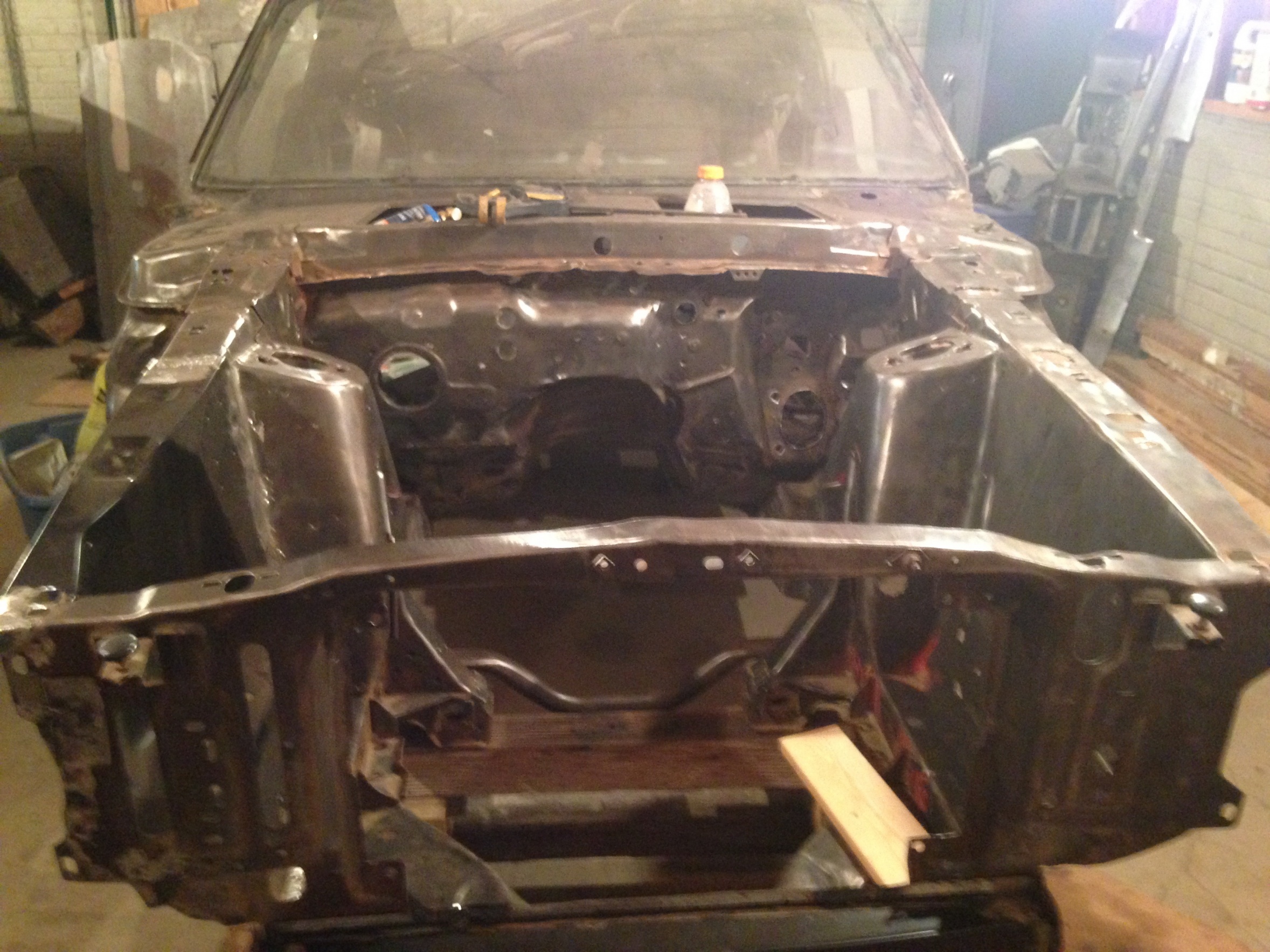

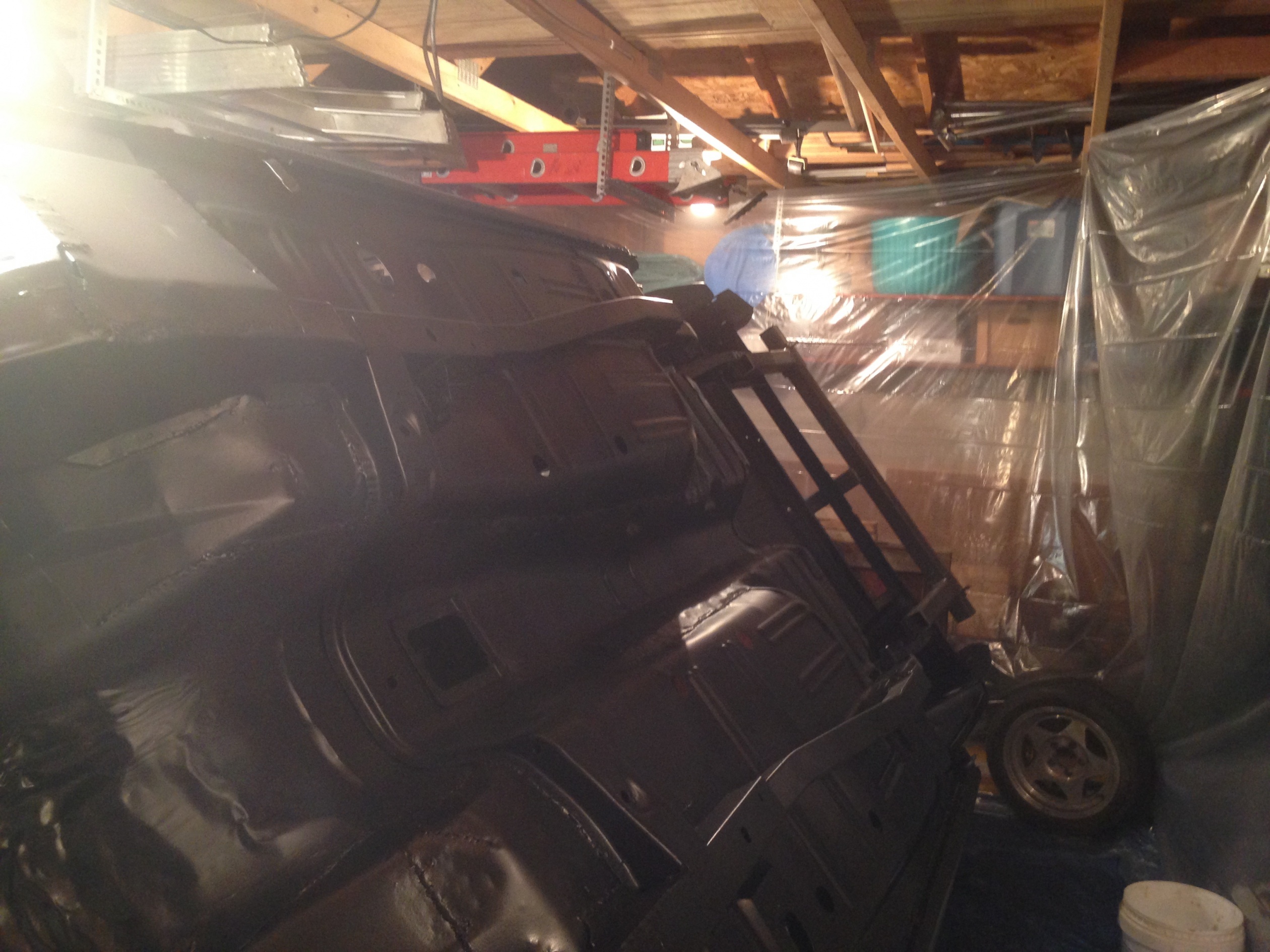

Here are the pictures of the primer I did a few weeks ago. I used PPG Shopline 377 Black Epoxy Primer. Sprayed very easy, came out okay. I didn't notice any runs or anything like that. It was my first time ever painting with a paint gun and I thought it turned out great.
Attached Thumbnails 1970 Fastback Build Thread-026.jpg   1970 Fastback Build Thread-027.jpg   1970 Fastback Build Thread-028.jpg   1970 Fastback Build Thread-029.jpg   1970 Fastback Build Thread-033.jpg
1970 Fastback Build Thread-035.jpg   1970 Fastback Build Thread-036.jpg   1970 Fastback Build Thread-037.jpg   1970 Fastback Build Thread-038.jpg   1970 Fastback Build Thread-039.jpg

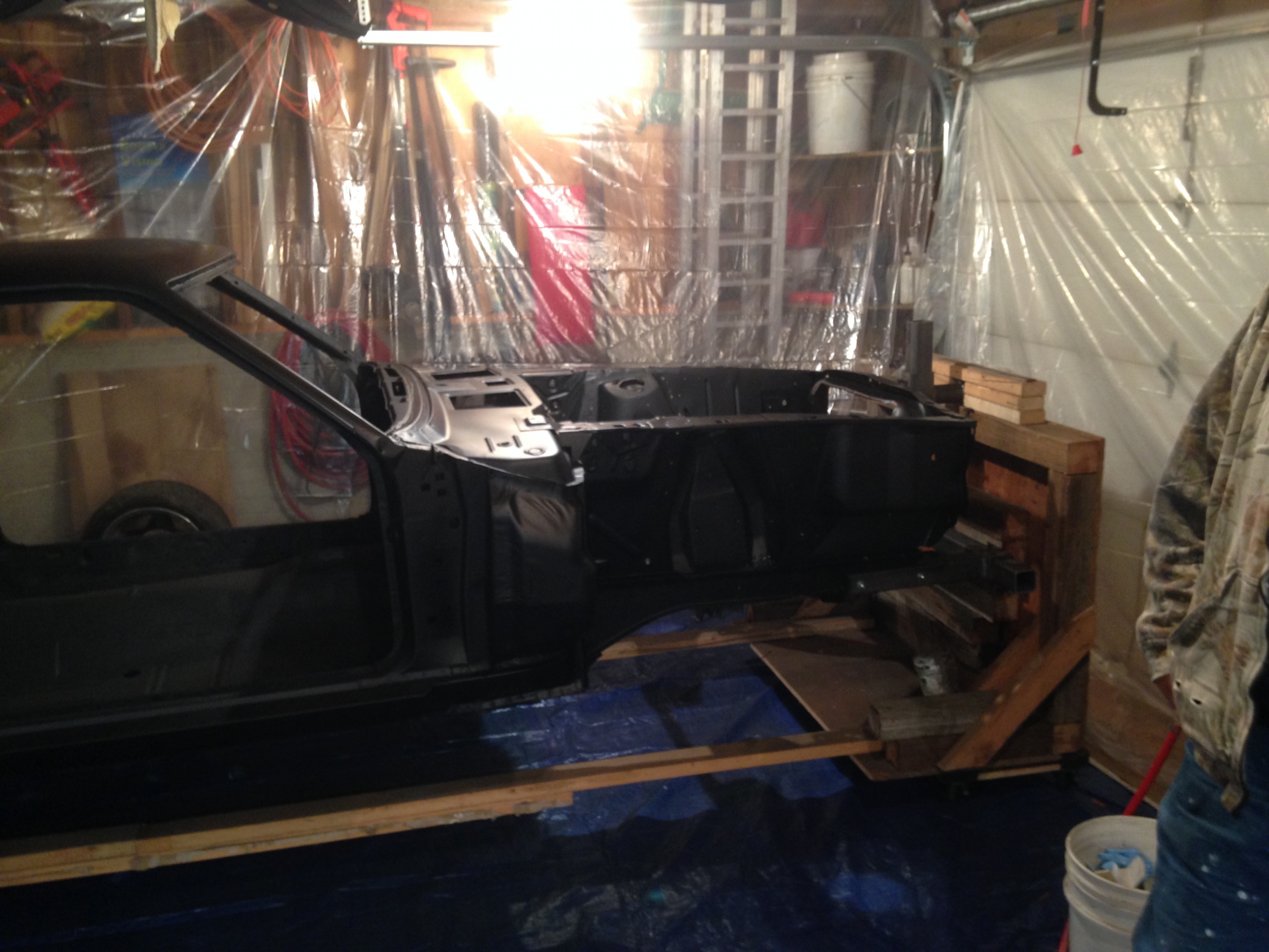

It's half and half. The part that connects to the car is steel square tubing and the frame that holds it is 4x4 lumber and 3/4" plywood

looks very strong to me. I see a lot of builders add stiffeners in different spots within the int. I don't see that in yours. Why is that, other than you didn't use them lol. Is that car stiff enough where they are not needed?
Old Jul 1, 2014 | 06:49 PM
fstbck70's Avatar
Joined: April 22, 2014
Posts: 84
From: Omaha
Didn't really think I needed them!!! Haha. But no, I put it on the rotisserie after I replaced the front torque boxes, both of the rocker panels are rock solid and the car is completely stripped. I also added subframe connectors too. That sucker isn't (shouldn't) flex an inch

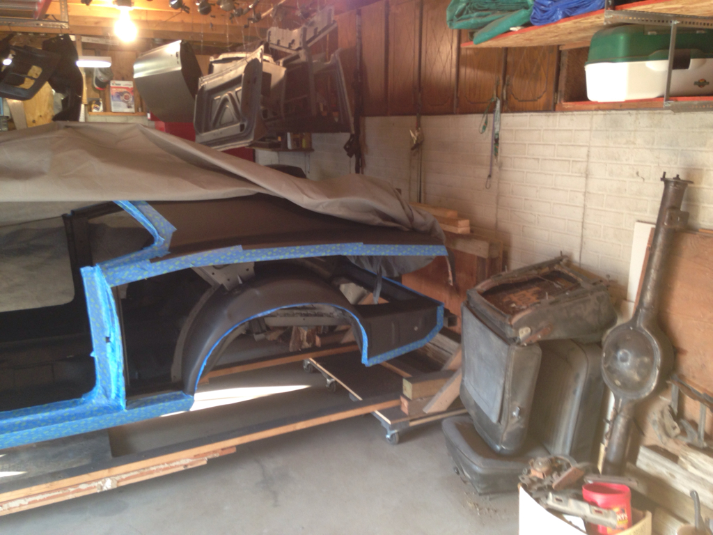

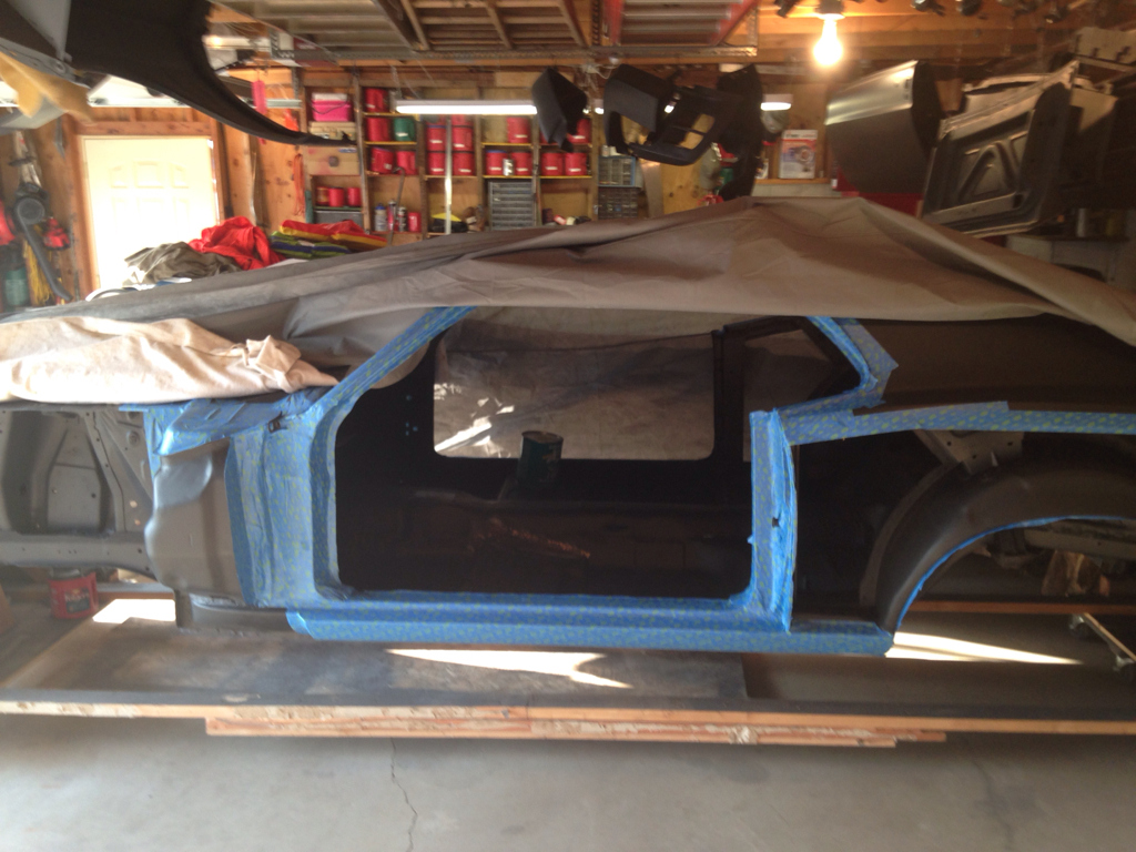

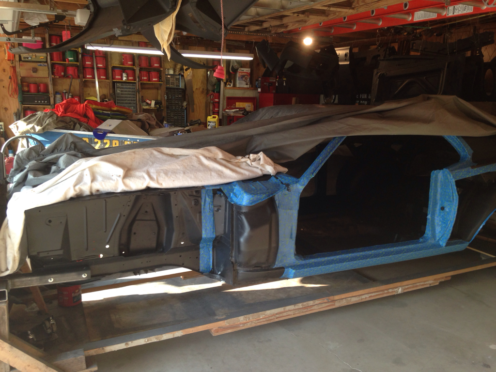

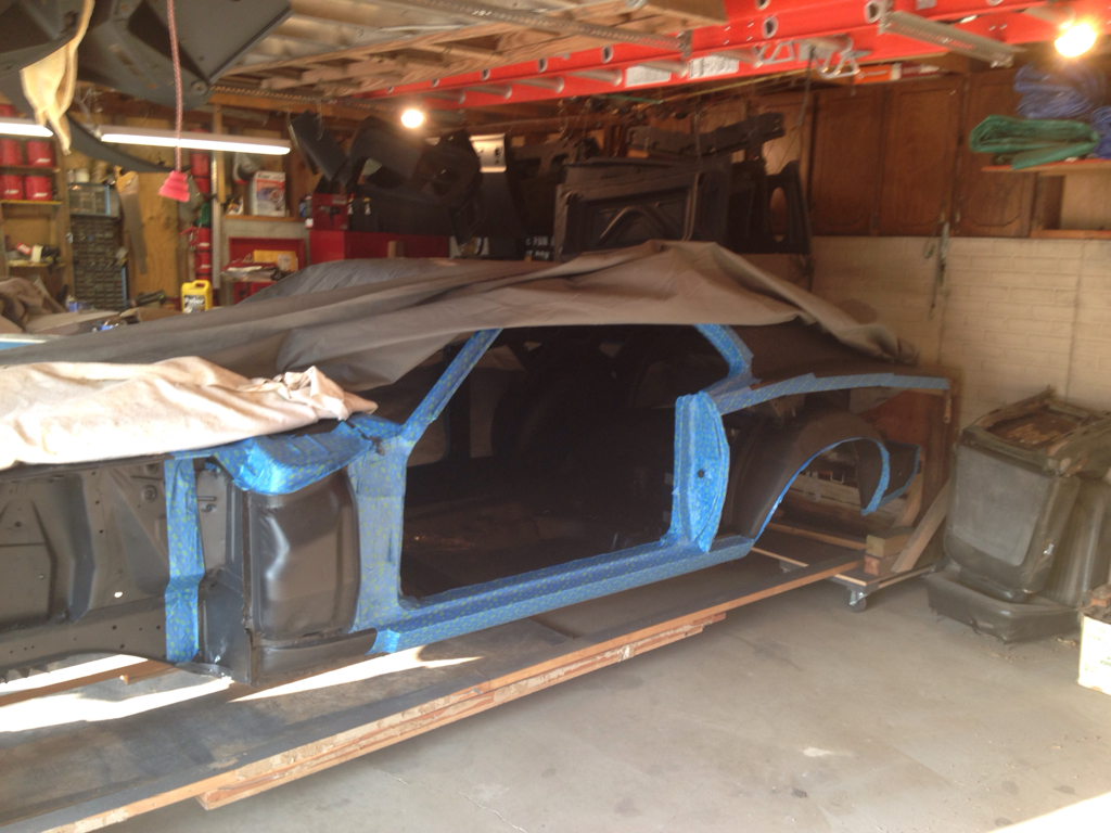

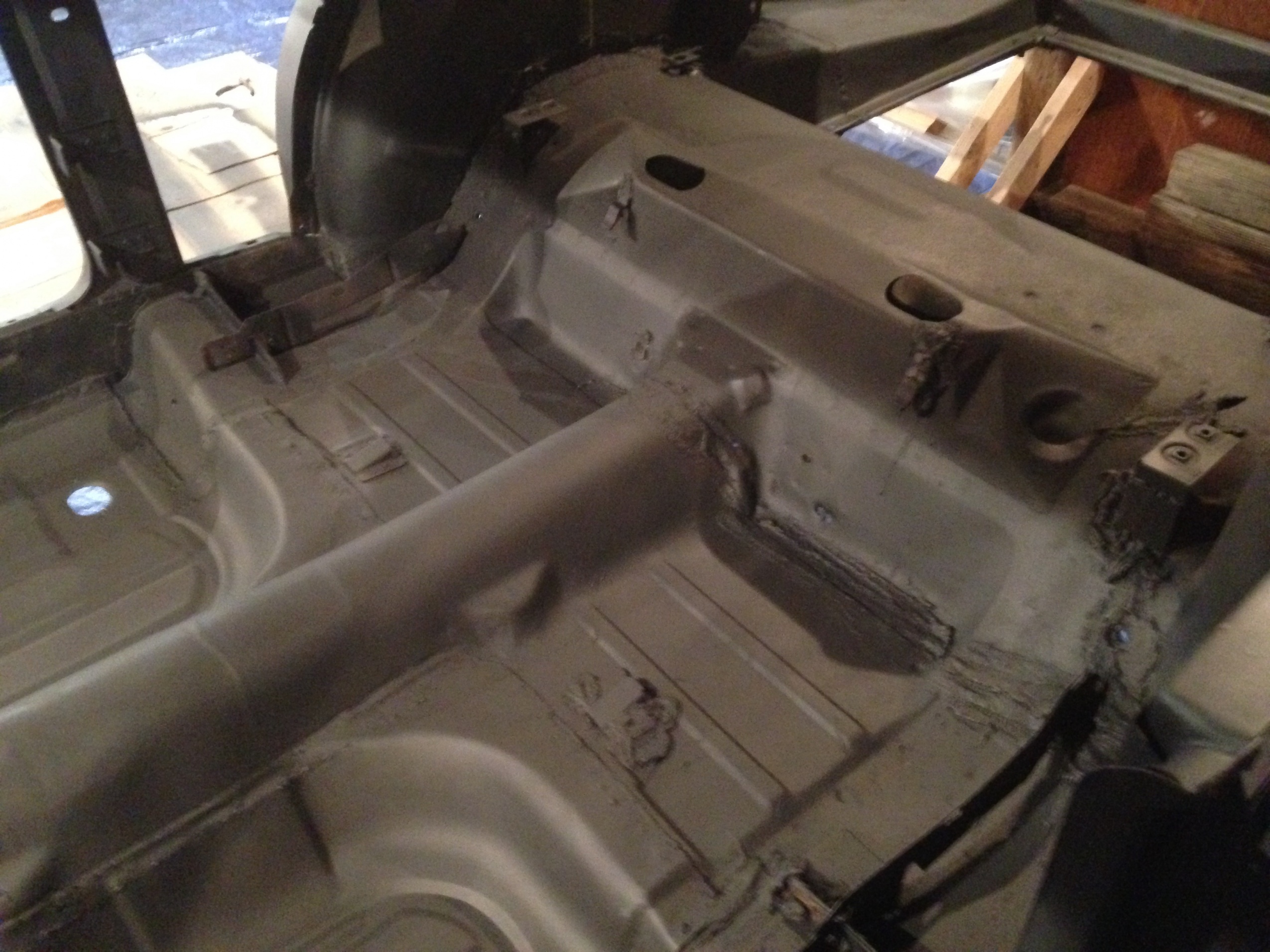

I was able to get a little work done today. I have gotten the underside looking good after I sanded in body filler to hide the weld seams. I also have masked most of the panels since I will be applying the raptor liner to the underside, trunk, and inside floor plans. I am still deciding for sure to do the inside. I also plan to do the outside of the engine bay awhile later after I get a new suspension in it.
Other than that I am still waiting for the rest of my panels to arrive at the end of July so I will have a complete car, body wise.
It's going to be a slow few weeks waiting, so if you have any concerns/experience about where I should/shouldn't spray the the liner, I'd appreciate your comments. I am mostly unsure of the doing the inside. Here are some pics. Sorry they are pretty boring. I forgot to take good ones until after she got tucked in. Haha
Attached Thumbnails 1970 Fastback Build Thread-image-481798855.jpg   1970 Fastback Build Thread-image-1491958692.jpg   1970 Fastback Build Thread-image-3739879420.jpg   1970 Fastback Build Thread-image-3054860501.jpg
