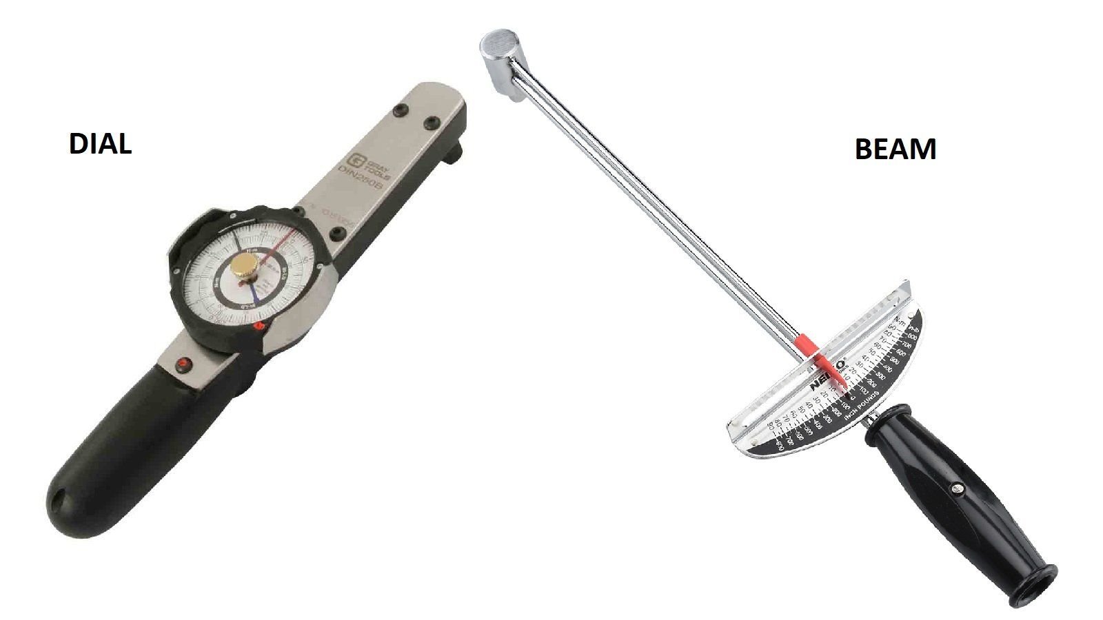

Beam vs Dial

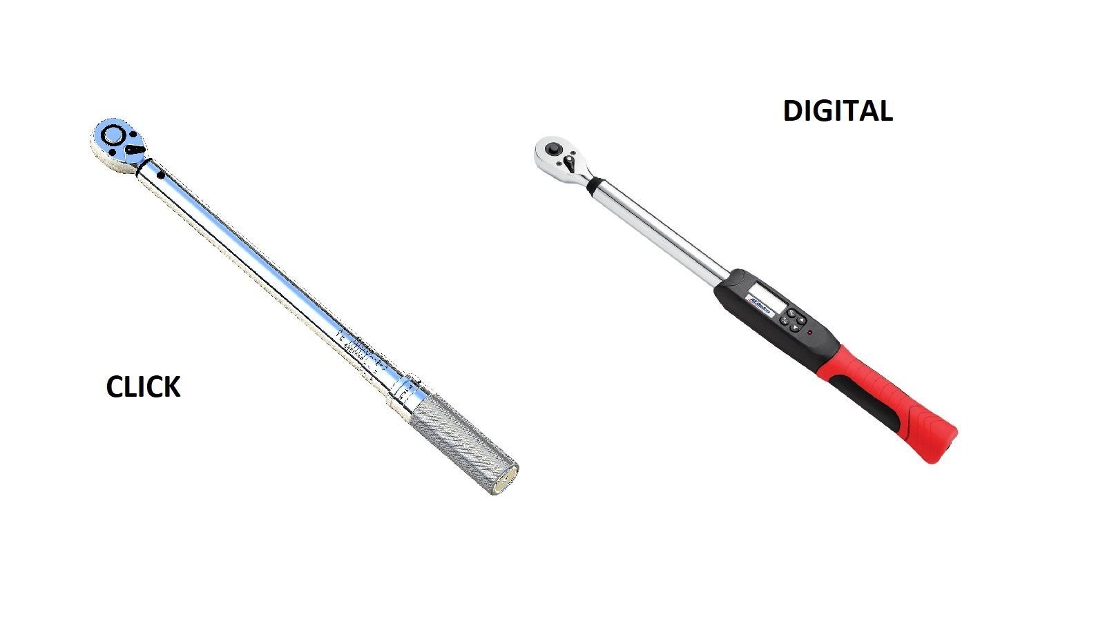

Torque wrenches come in several different styles including beam, dial, click-type, and digital. Beam wrenches are designed with a material that flexes as force is applied, but a stationary arm sits over a gauge that indicates the torque value. The beam torque wrench is typically the most durable and inexpensive type of torque wrench but tends to be the least accurate. Dial torque wrenches indicate the torque value with a needle on a round analog dial, which is typically more accurate than a beam wrench, but minor variances in torque values can occur from parallax error when reading the gauge. These can be offered with a type of light or buzzer that indicates a specific torque or even have a second needle that acts as a "memory" function for the torque that was applied.
Click vs Digital
Click-type torque wrenches allow users to set the wrench to the specified torque value before tightening a fastener. The wrench will then break-over or "click" when the preset torque value is reached. These often provide the best bang for the buck in terms of accuracy and durability for a relatively cheap price. The digital torque wrench is the most costly, yet typically the most accurate type of torque wrench on the market today. These electronic wrenches use a strain gauge to measure the force applied and generally have a margin of error of less than 1%. These wrenches have all the bells and whistles such as a memory function, audio indicators, different units of measurement, and more.

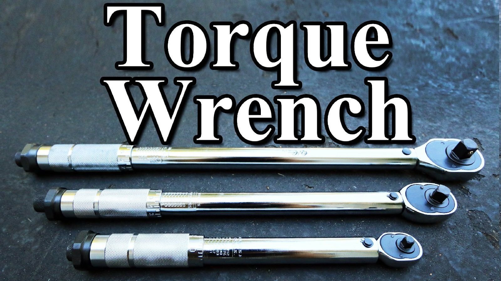

Choosing the correct tool for the job is a motto to live by when doing any type of automotive work, and this is especially true when using a torque wrench. Torque wrenches come in various sizes and working ranges thus a small 1/4" drive inch-pound torque wrench just isn't gonna cut it when having to tighten lugs nuts to 100 foot-pounds. In general, mechanical torque wrenches have an accurate working range of 20-100% of their scale and digital wrenches 10-100% of their scale, so choosing the appropriate size wrench that will tighten your specific fastener within its working range will yield the best results.

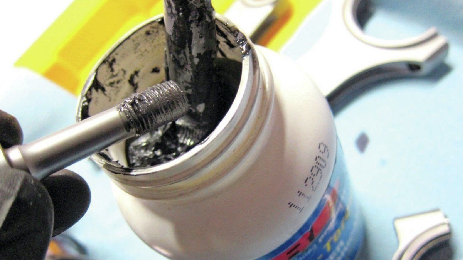

So you have the proper torque wrench picked out and you know Ford's suggested torque specification for the fastener you intend to tighten, but does that fastener require any lubrication be applied to the threads? Lubrication greatly affects the coefficient of friction when tightening a nut or bolt. Some sources indicate that a lubricant such as anti-seize can alter the torque reading by as much as 40%. Be sure to check whether Ford intends for the fastener to be installed dry or with a lubricant such as oil, anti-seize, or even threadlocker compound applied to the threads.

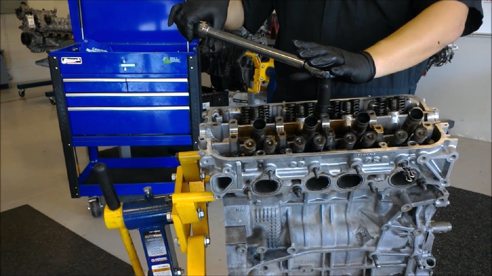

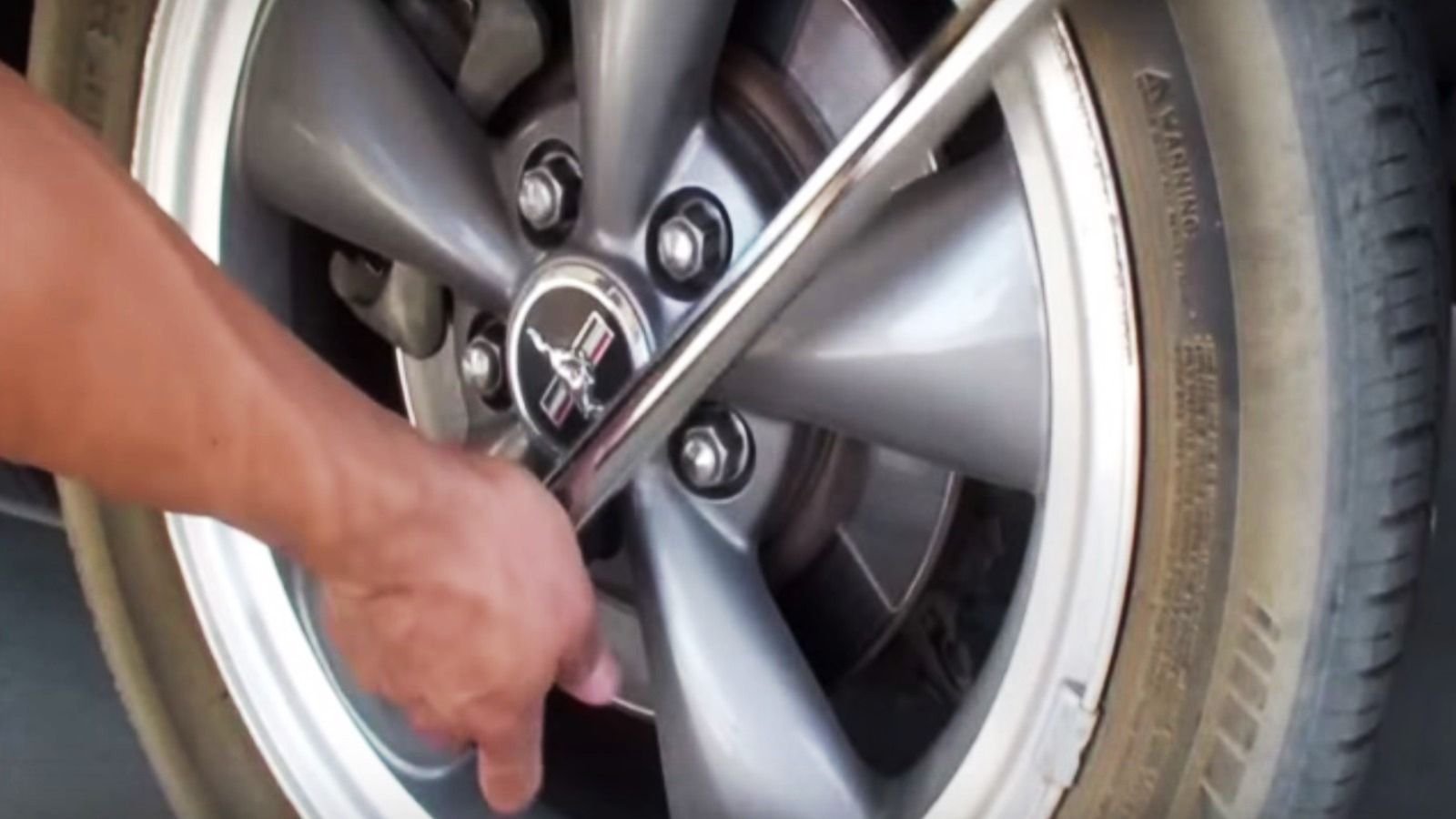

A torque wrench should not be used as a primary tightening device to run a nut or bolt down, but instead used only as a tool to achieve the final torque value. Fasteners should be torqued to specification in one single pull unless otherwise stated. For parts like cylinder heads or wheel lugs nuts (or any torque + angle spec), torque should be applied in a specific sequence and increasingly tighter until the correct values are achieved.
