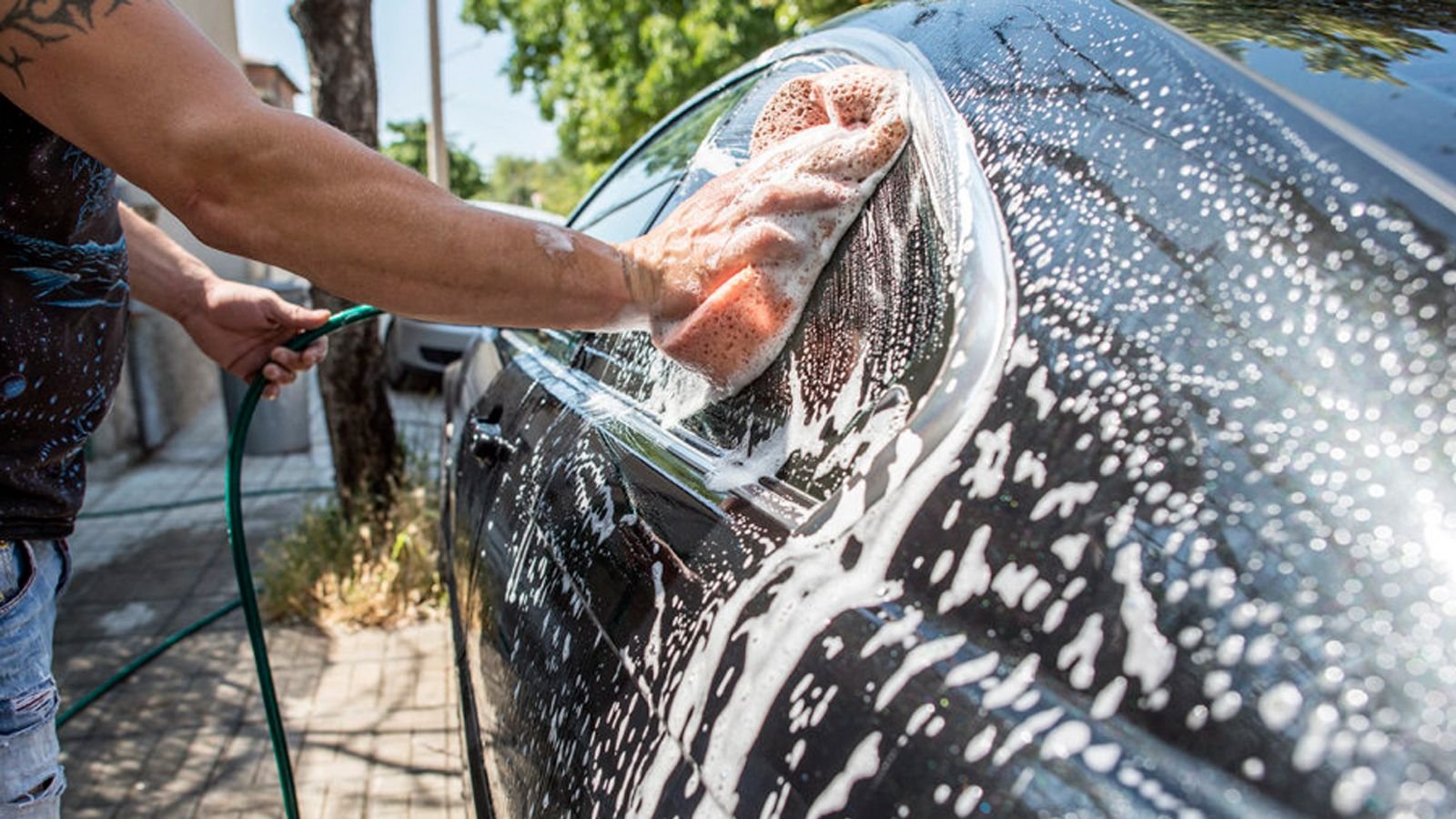

Next would be the shampoo. There are plenty of good shampoo options available for you at your local auto supply store, the important variant here are the mitts. Be sure to use nanofiber mitts to wash your car to avoid leaving scratches on your clear coat.

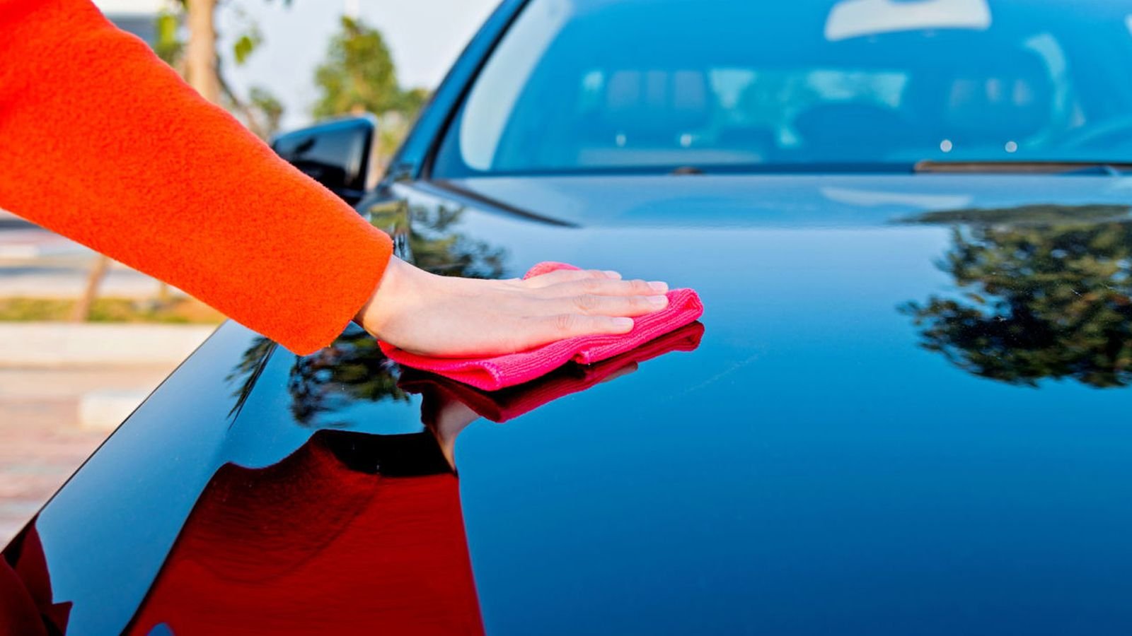

To start, you will need some very soft and absorbent microfiber towels. You will want to essentially apply the chemical spray onto the car panel by panel. You can then proceed to wipe it in one direction. Make sure not to push on the surface of the paint too hard, or you will scrape the dirt that your water free wash product has just removed right back onto your paint. Check out a more thorough description and directions on water-free car washing right here.

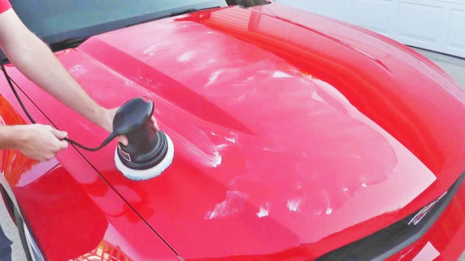

Polishing your damaged paint is a critical part of the rehab process. It needs to be done right, or the consequences can be severe. Using a dual action polisher is very highly recommended to minimize your risk of error. You will want to use soft pads and finer compounds to avoid leaving swirl marks on your paint, especially, if you have darker color paint. Here's a step by step guide to doing this effectively

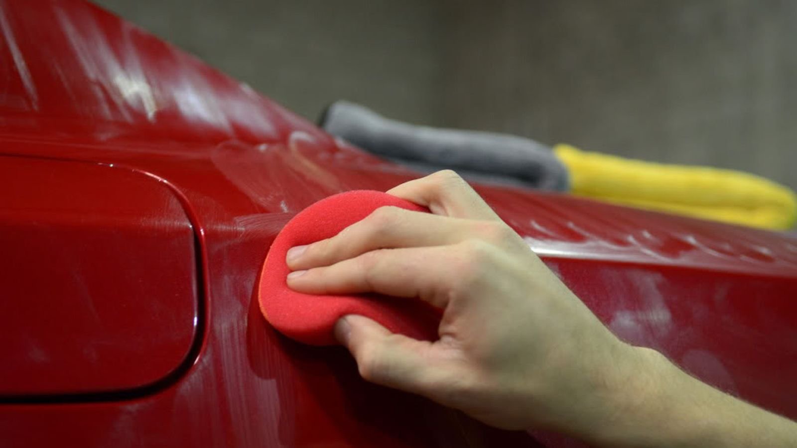

Classically, waxing is a well-established option for blocking outside threats from reaching the paint. Wax comes from various natural sources and provides protection for your paint, as well as a beautiful deep gloss shine. Having completed the previous steps, proceed to apply wax to every panel of your car until it is fully covered. You might naturally miss a few spots here and there so make sure to double check every part. As with everything else, be careful and apply gently. A good wax should technically keep you away from the car wash for a few months.

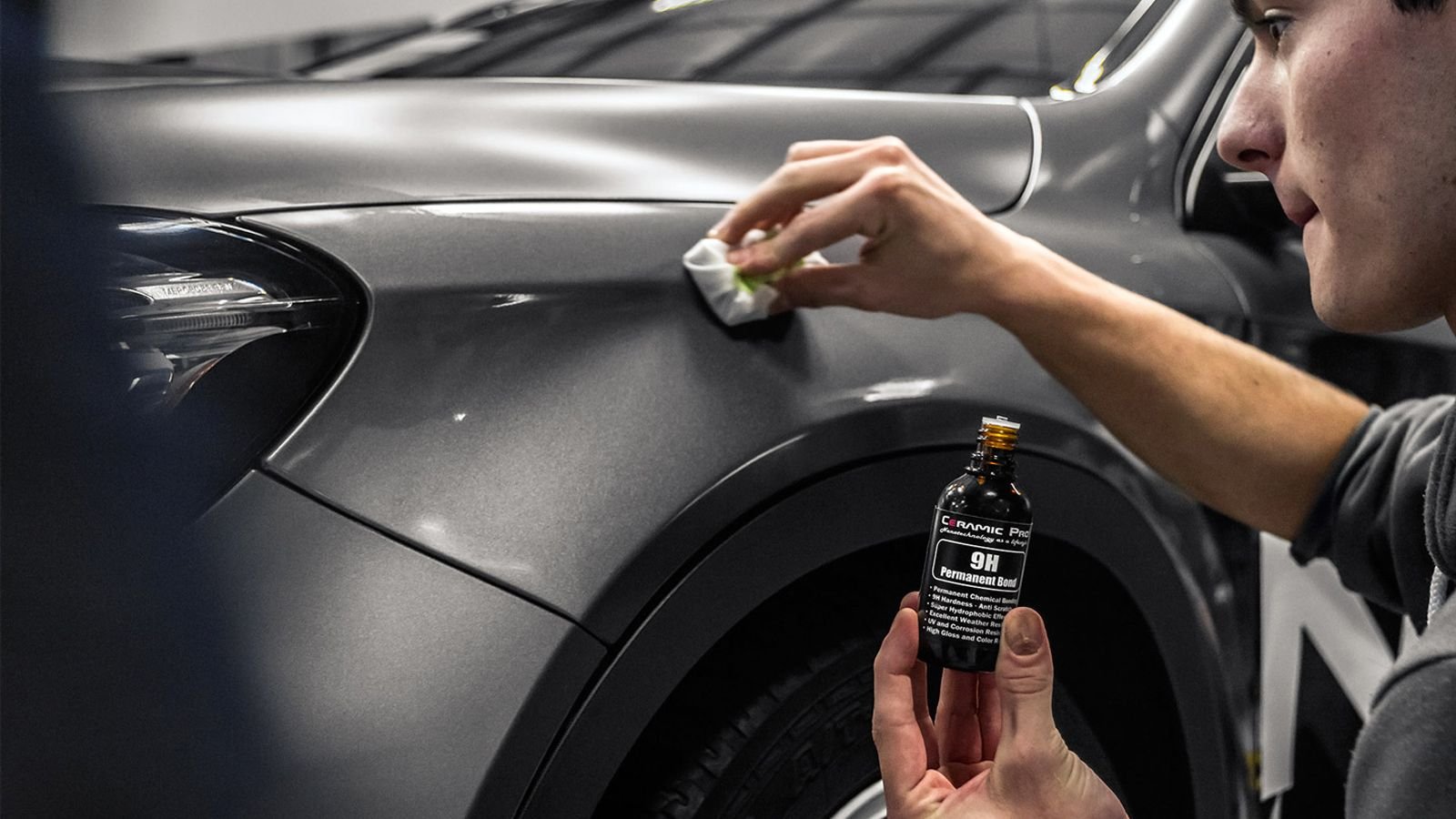

This is much more of a commitment than the other 2 kinds of paint protection. Also referred to as ceramic, or nano coating, the process involves permanently coating your vehicle's paint with a protecting clear, shiny coat of liquid that bonds to the paint, creating an additional layer of protection. These coatings are often water repellent as well, making your car less likely to get dirty or get stains in the first place. The coating essentially becomes a part of your paint. The only way to remove it would be to polish it down, or by natural wear over the years.
