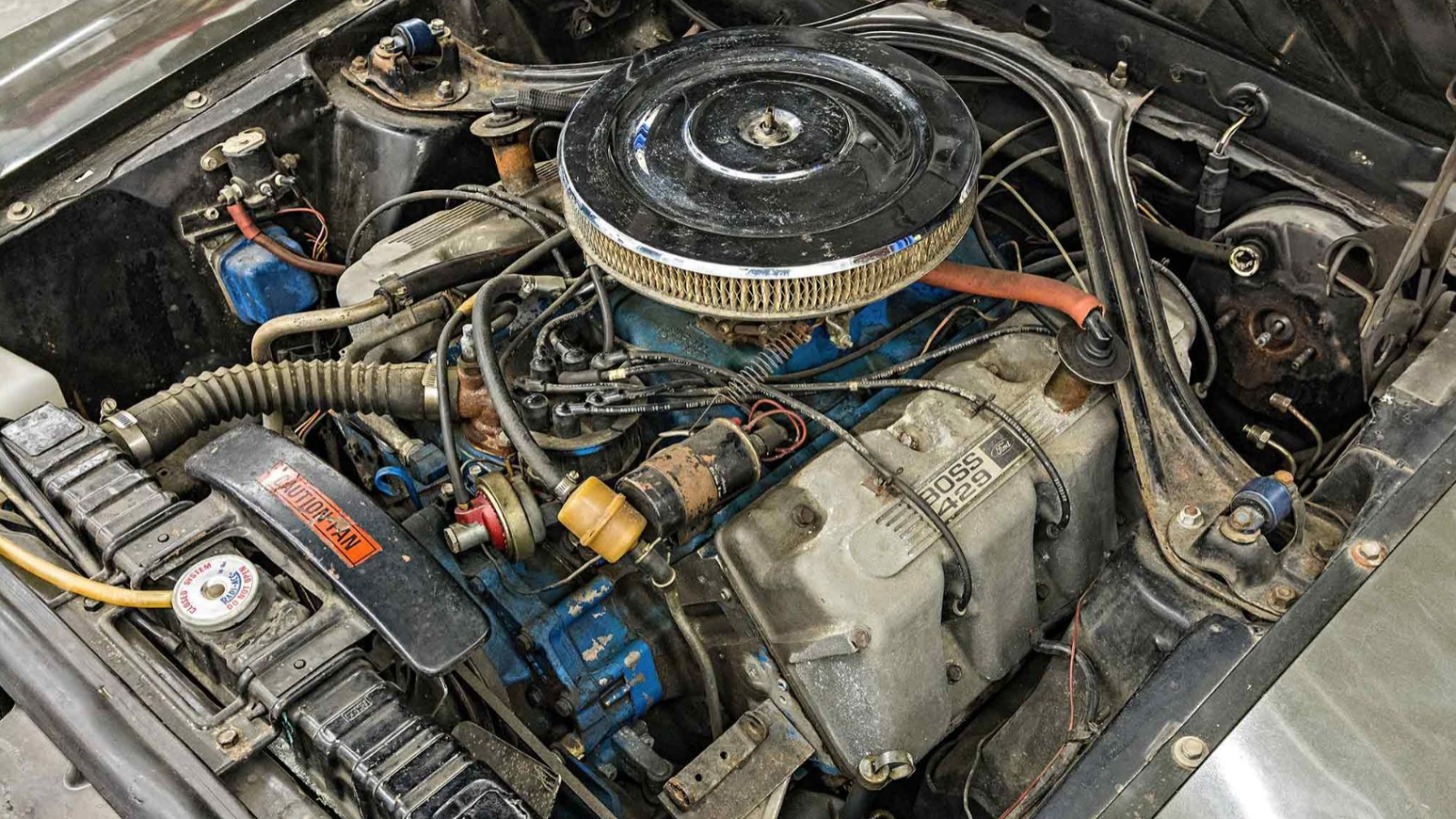

As the Muscle Car Restorations team gingerly peeled parts away from the beefy casting, clues began to slowly confirm the team's suspicions of an abusive (but horrendously fun) racing history that may have graced her early days. Though this is speculative, tell-tale signs of extensive engine work (including a rebuild, at one time) were becoming more and more evident as the team dug deeper.
>>Join the conversation about the this 1969 Boss 429 right here in The Mustang Source.
The Chosen Ones

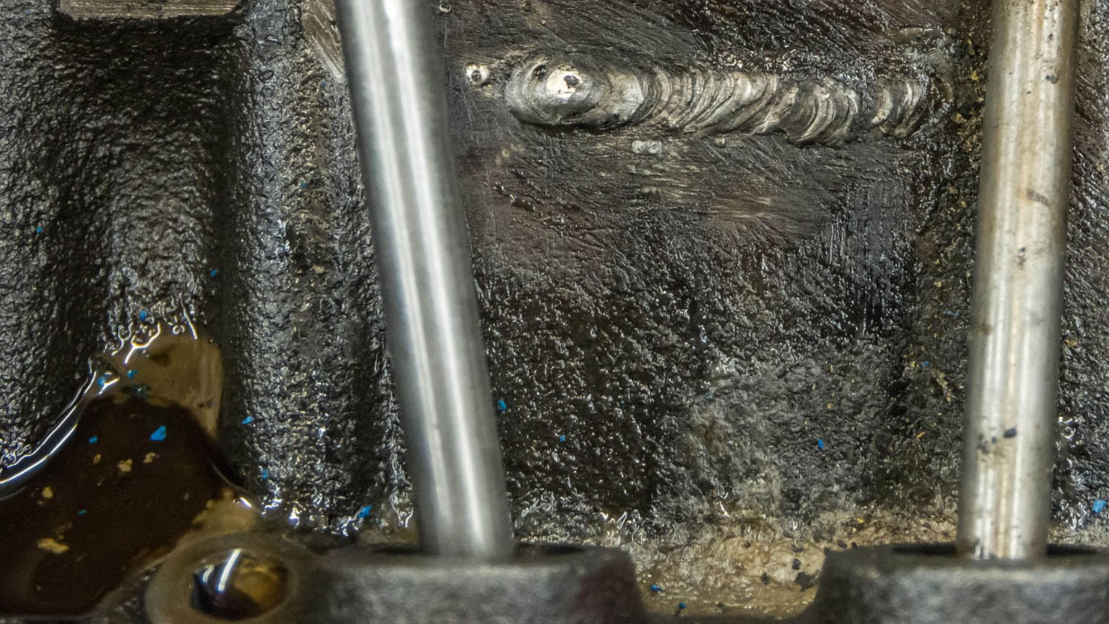

The car came under the knife with oversized cylinders, undersized crank journals, a Crane cam, a welded block, a busted pushrod, a cracked crankshaft, and a set of '70 Chevelle heads...at 27,000 miles! It's hard to justify these findings by any other hypothesis than heavy racing. One could speculate that the engine, already on its first rebuild, snapped the pushrod tip at the rocker, thus knocking it out for the long run.
New 0.060" oversize pistons were used with the original rods - only essentials were to be replaced.

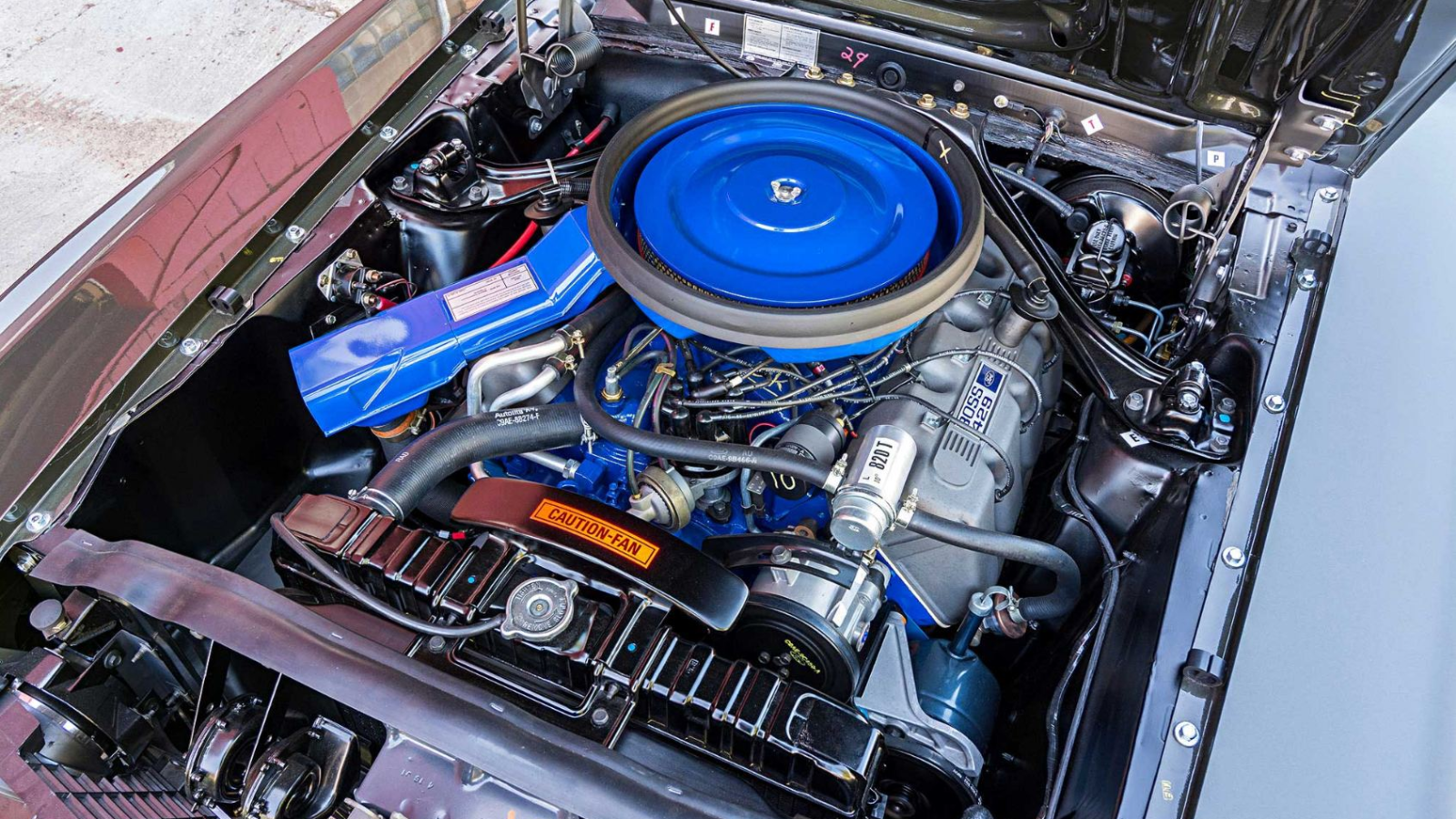

When the engine finally made it back into the Boss 429, it was practically factory fresh. The extensive attention to detail is absolutely phenomenal; the team troubled themselves to replicate every stamp, paint mark, grease pencil marking, and sticker that it was originally assembled with. Thousands of documents, records and photographs were used to accurately revive the factory condition.

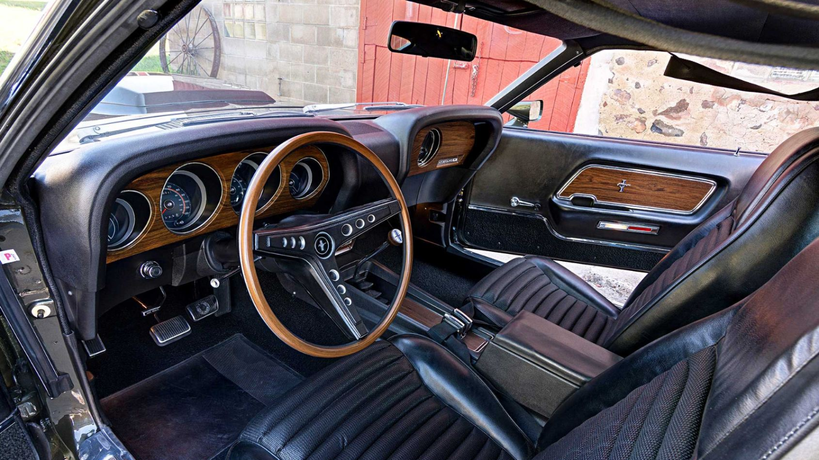

Tending to the engine and mechanical aspect was a monumental task, but the interior was just as needy. The wear on it was surprisingly minimal and fairly consistent on a car with less than 30,000 on the odometer. What wasn't consistent was the putrid stench that had to be thoroughly removed.
This meant cleaning...EVERYTHING!
Gentle Deliberation

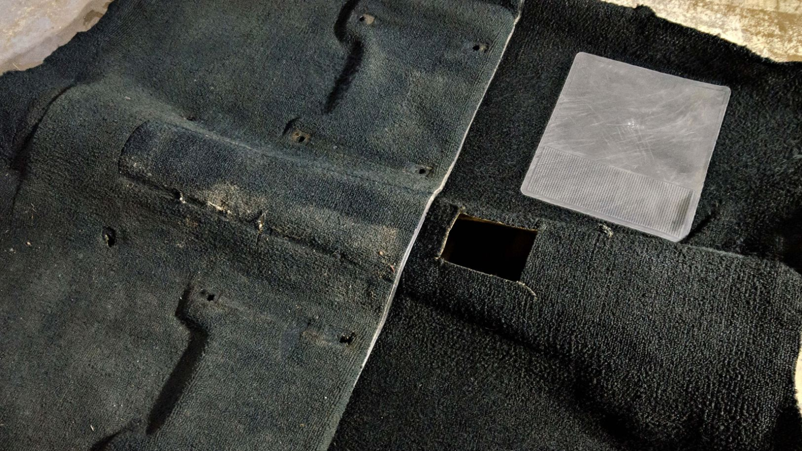

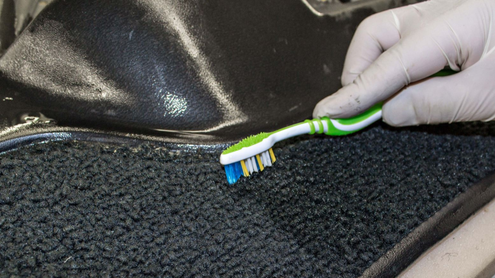

To accomplish the team's vision of a genuine article, studious care had to be implemented in the restoration techniques used. Highly abrasive (and highly effective) degreasers and shampoos were substituted for mild solutions that would work just as well...with 10 times the effort!
Stark Contrast
Although it may not be "factory-fresh," it's as close as you could possibly get with the original carpet - and for what they started with, you really can't complain much! It's amazing what a little elbow grease can do with the proper tools and techniques. The Muscle Car Restorations team had all the know-how and experience, which played a pivotal role in the project's success.

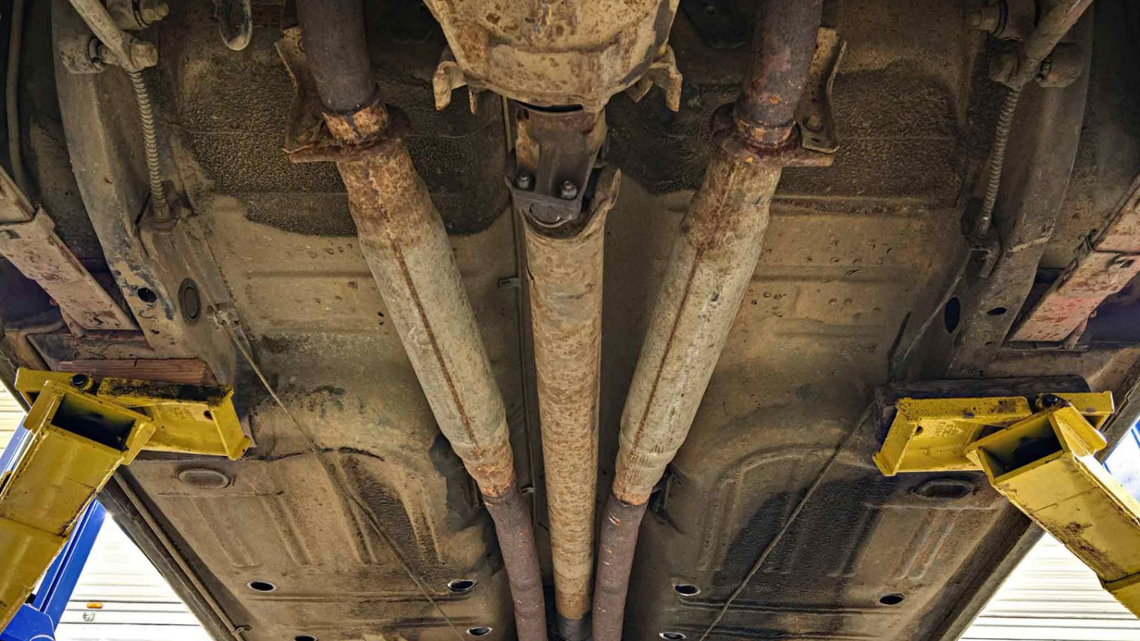

Everything underneath the car was about as perfect as you could ask for, even the factory pipes and resonators were in place. A coat of surface rost kisses every visible steel surface, as would be expected. But, since it spent its last 40 years indoors, there wasn't much a little WD-40 and quick whack with a ball peen couldn't solve.

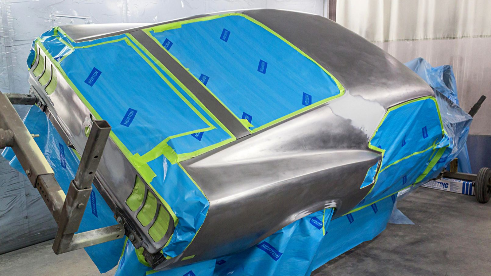

An essential part of any frame-off restoration, the rotisserie was employed to allow the access to every inch of the body. The car was taken down to bare metal and - with more care than the factory - worked into the masterpiece you see today.

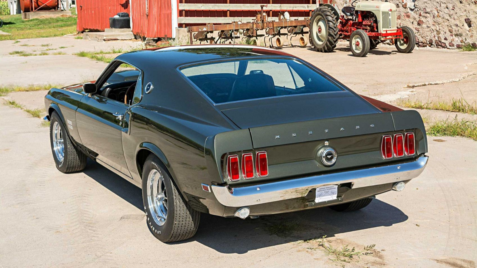

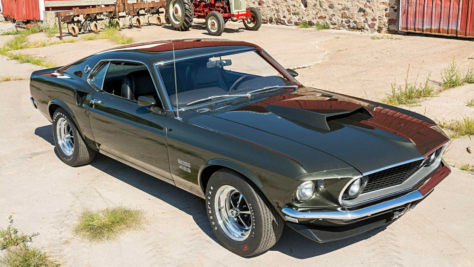

Fresher than the day it rolled off the line, the Boss is back! The meticulous attention to detail shows is a quality of work that is second to none - but don't be surprised to see it light the tires up every now and then. After all, it is a Boss 429!
