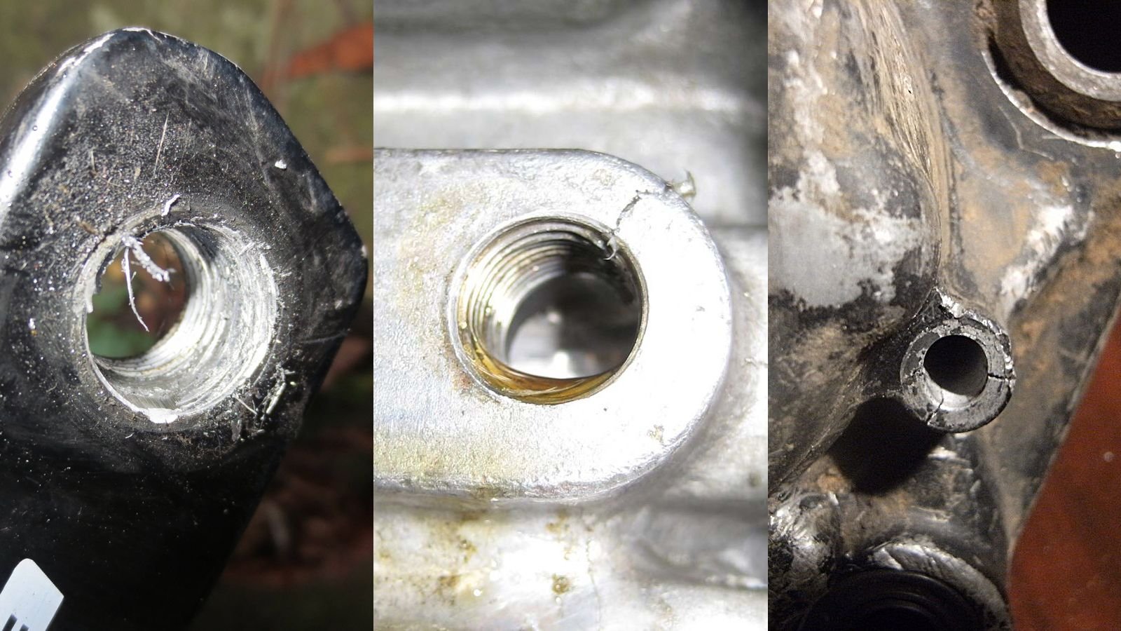

1. Anything into Aluminum
They say the stock market runs on only two emotions: fear and greed. We can get greedy when working on our cars, sure, but more often we get scared. Our two primary fears are Fear of Leaks and Fear of Loose. Either one of these can tempt the most reasonable among us to just give it just one extra half-turn. If a little is good, we tell ourselves, then a little bit more must be a little better. Aluminum seems to agree with us, it will give us that little bit more, even though it doesn't want to. Don't let fear make you greedy. Don't be what European sports car mechanics used to derisively call "cast iron mechanics." Get familiar with the correct torque specifications for everything on your car and follow them. A few extra lb-ft of torque isn't going to help seal a leak or keep something from loosening—tightness isn't a substitute for good sealing surface prep and can't do the job of retaining systems (Loctite, Nyloks, lock washers, cotters, safety wire, stud elasticity, etc.). If the thoughts running through your head go something like, "let's see if it will take a little more tightening," then you are tempting fate for no reason. You might even have gone past the point of no return and stripped threads out or cracked a casting (see above) in the past, subsequently promising yourself you wouldn't make that mistake again. Listen to yourself. Knowing the correct torque will eliminate guesswork, and fewer guesses equal less fear.

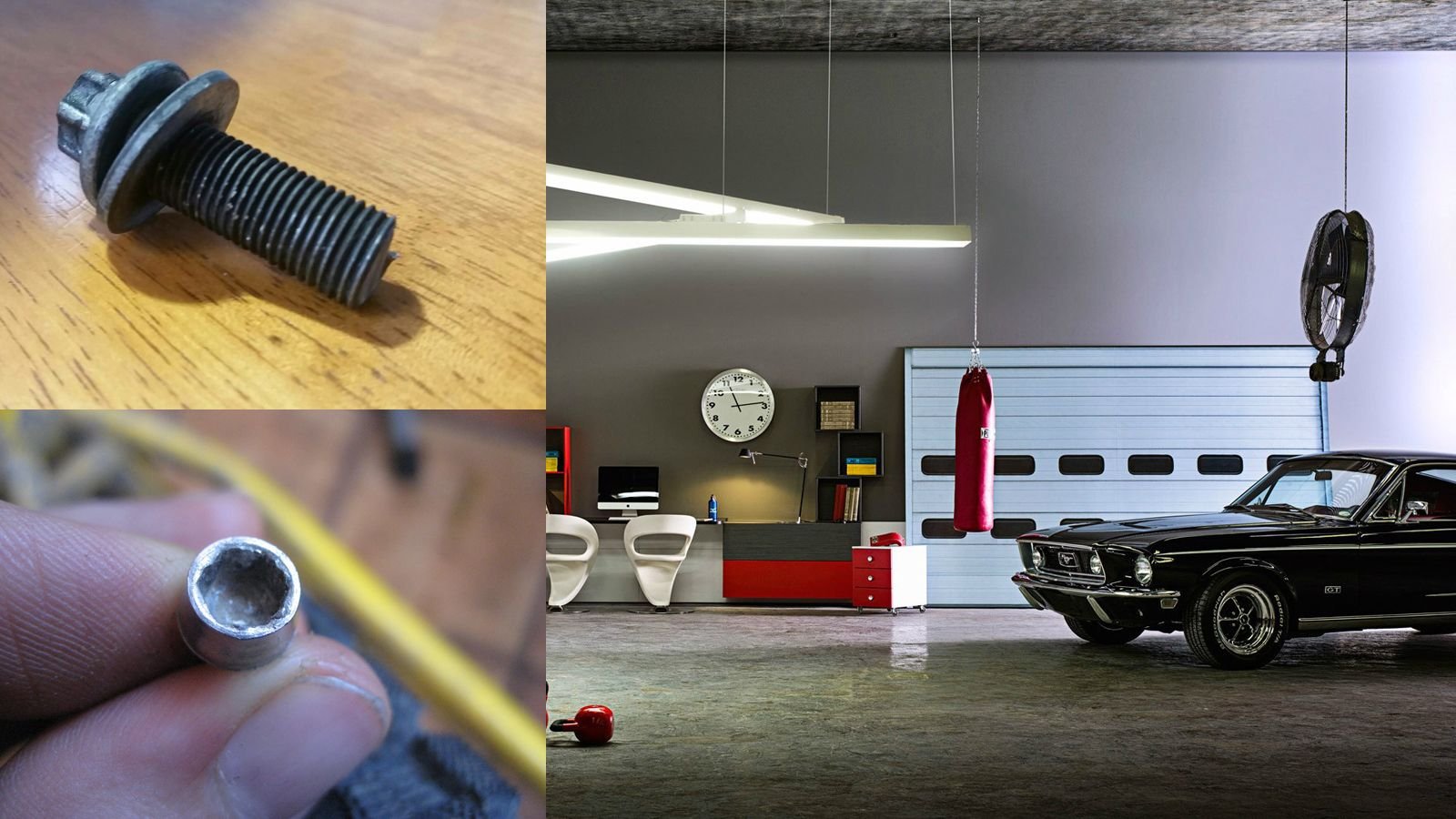

3. Anything 8mm
Why 8mm? Because it's human-sized. Humans need a little help to torque a 12mm or a hardened 10mm bolt to spec—like a longer lever—which reminds us we're playing with bigger stakes. Similarly, most people know the importance of using a torque wrench on cylinder head and main cap fasteners. Us big, strong humans are also aware that we can easily overpower puny 5mm and 6mm threads so we go easy on them. But 8s are friendly. We can tighten them the right amount without too much difficulty. The difficulty enters the picture when we get greedy or scared and go for just a little bit extra. It's way too easy to pull threads out of a casting or, when the fastener goes into something stout, to strip 8mm threads or hexes. Learn the correct torque rating for the grade and thread pitch of your fastener and the application it is designed for—even on something as friendly as an 8mm nut.
