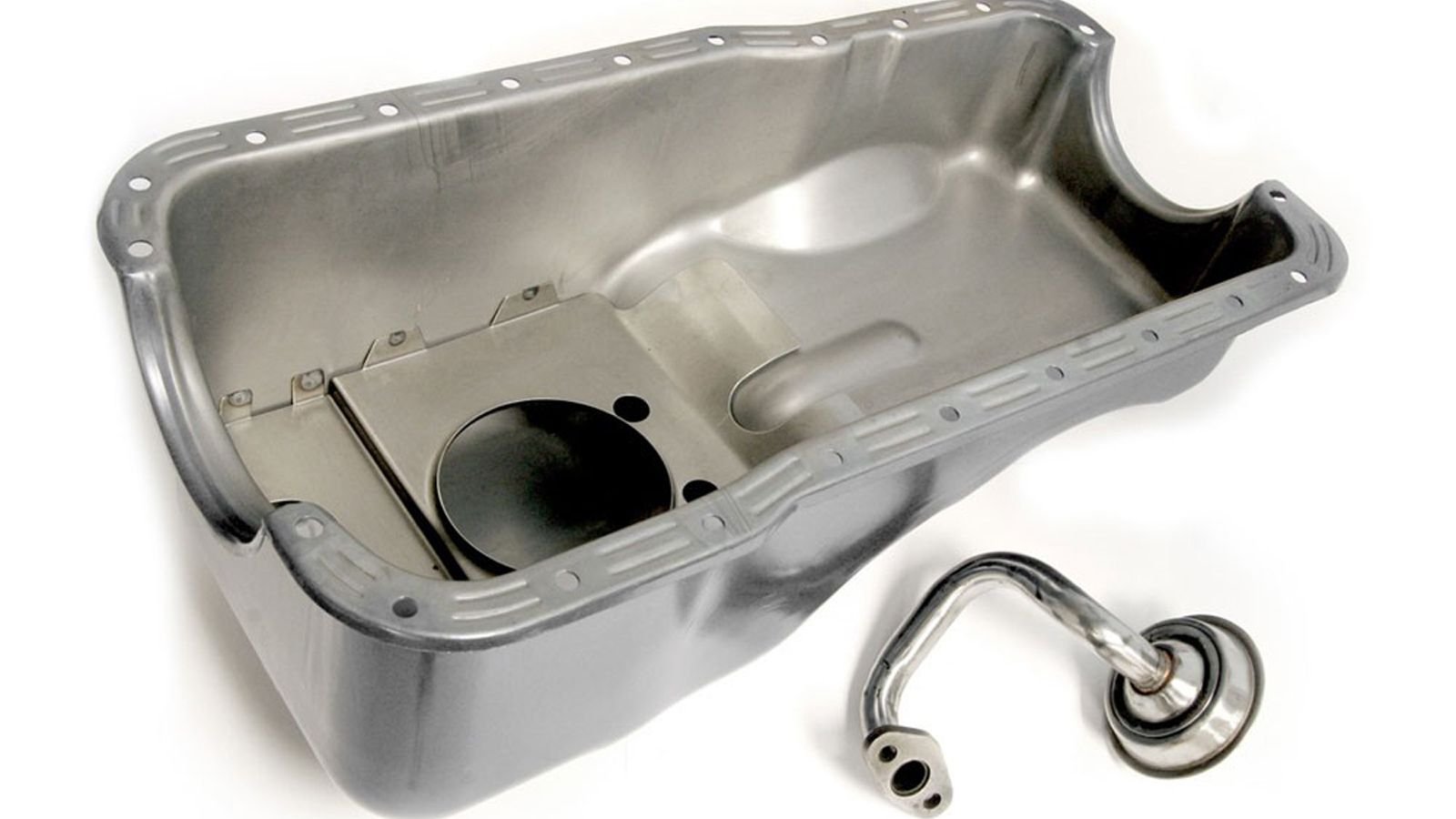

4. Too Much Air
Air is a little like water—you need it but only in the right places. Air likes to get in where it's not wanted though, so we have to keep pushing it out. Like in our brakes, obviously, but also in our cooling and oiling systems. Put an oil pan on that's just a little too deep, or an oil pick-up that's not deep enough, and next thing you know there's air where your oil should be. Get that all sorted and go around corners a little too hard and there's air again, ready to get sucked in when your oil is sloshing around. In the words of the Talking Heads, "Air can hurt you too."
