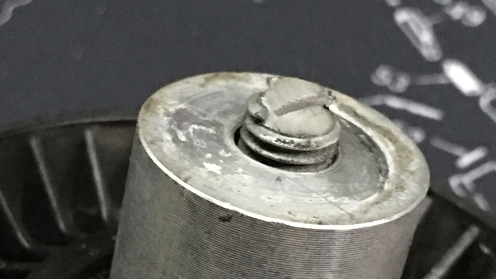

If these sound really basic to you that's because they are really basic. Pesky human nature keeps us doing the right things the wrong way. As kids, we learned how Bugs Bunny could make a wheel come off the Coyote's rocket bike, we've been scared ever since.  That fear that something might come loose and kill us has been whispering to us 'Tighter, tighter' every time we work on a vehicle. Drain plugs, lug nuts, oil filters, rocker locking nuts—all things that make you nauseous when you imagine them coming loose, all stuff that is routinely over-torqued. Sure, we all follow torque specs for head and main bearing fasteners, but every combination of metal, diameter, thread pitch, length, depth, and heat range has an ideal tightness it likes. Go past what it likes and metal will pack it up and go home. And metal will often tell you what a torque wrench won't. Lots of people snap studs off or pull threads out using a torque wrench. Pay attention to how soon a fastener gets tight or if it doesn't ever get tight enough. Metal rarely lies to you.
