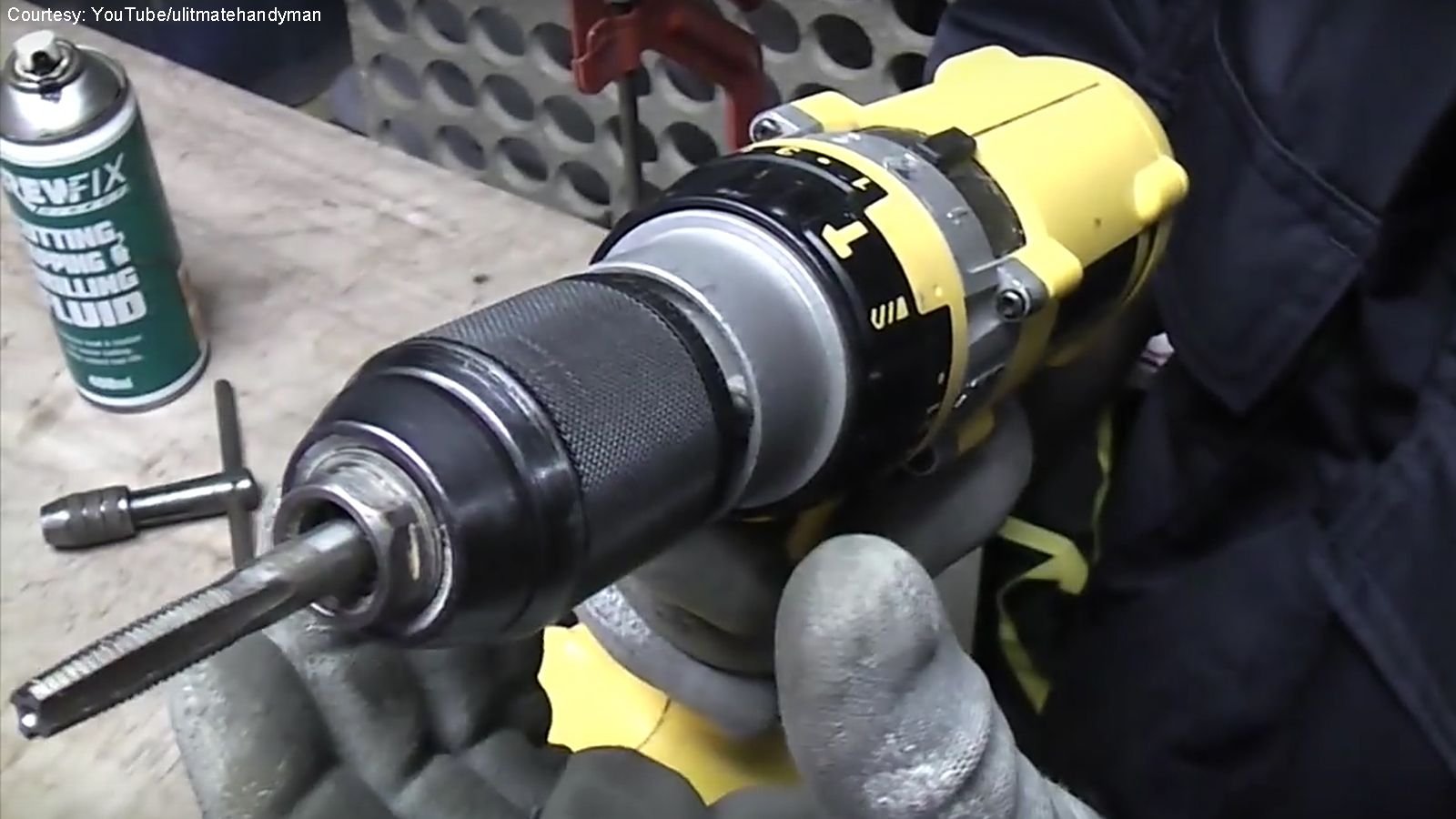

3. A Drill and a Tap, Together
Time is the enemy. Sometimes the things we do to steal back a little time end up costing us when we are least ready to pay. Come to think of it that's usually when we try to cheat time. Using a drill, drill press, or mill to drive a tap (sometimes called power-tapping) is not recommended. Metal is unpredictable, and hard to see through. Even if we prepped a piece—such as the existing threads in a casting—by thoroughly cleaning them and using plenty of cutting fluid, it's still easy to hit a bit of corrosion that could cause your tap to jam or break. If you are power-tapping you're not going to be able to feel a problem, and shut things down, before you break a tap off inside a part. And power-tapping makes it difficult to feel any binding due to excessive metal chips that could have the same effect. In short, power tapping is best left to Reb Beach.

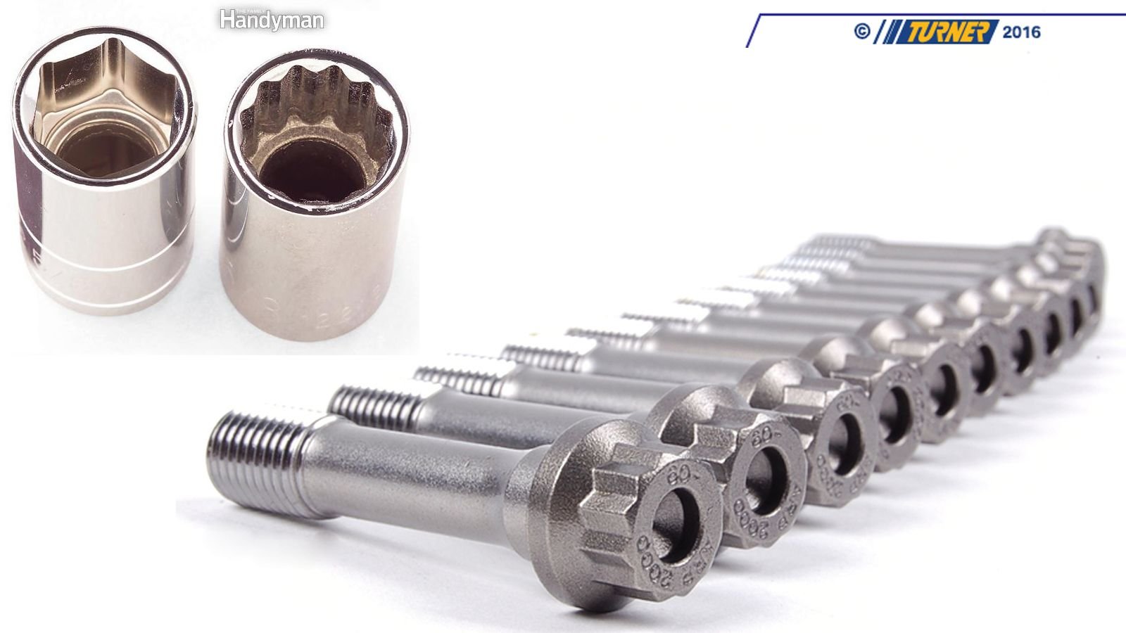

4. 12-Point Sockets
Know what you should be using 12-point sockets on? Twelve-point nuts and bolts, like rod bolts for instance. Craftsman used to sell a packaged set of tools they called a 'mechanics' set. Why was it called that? Because it included only 6-point sockets; not a 12-point in sight. Even Sears knew what's up. Excuses can be made for employing a 12-point box wrench—sometimes you don't have enough access to swing 1/6 of a turn with a wrench. And yes, the best flank-drive 12-point tools will rival the gripping and damage-avoiding abilities of lesser 6-pointers—but a 6-point socket gives you superior grip. Don't you want superior grip?
