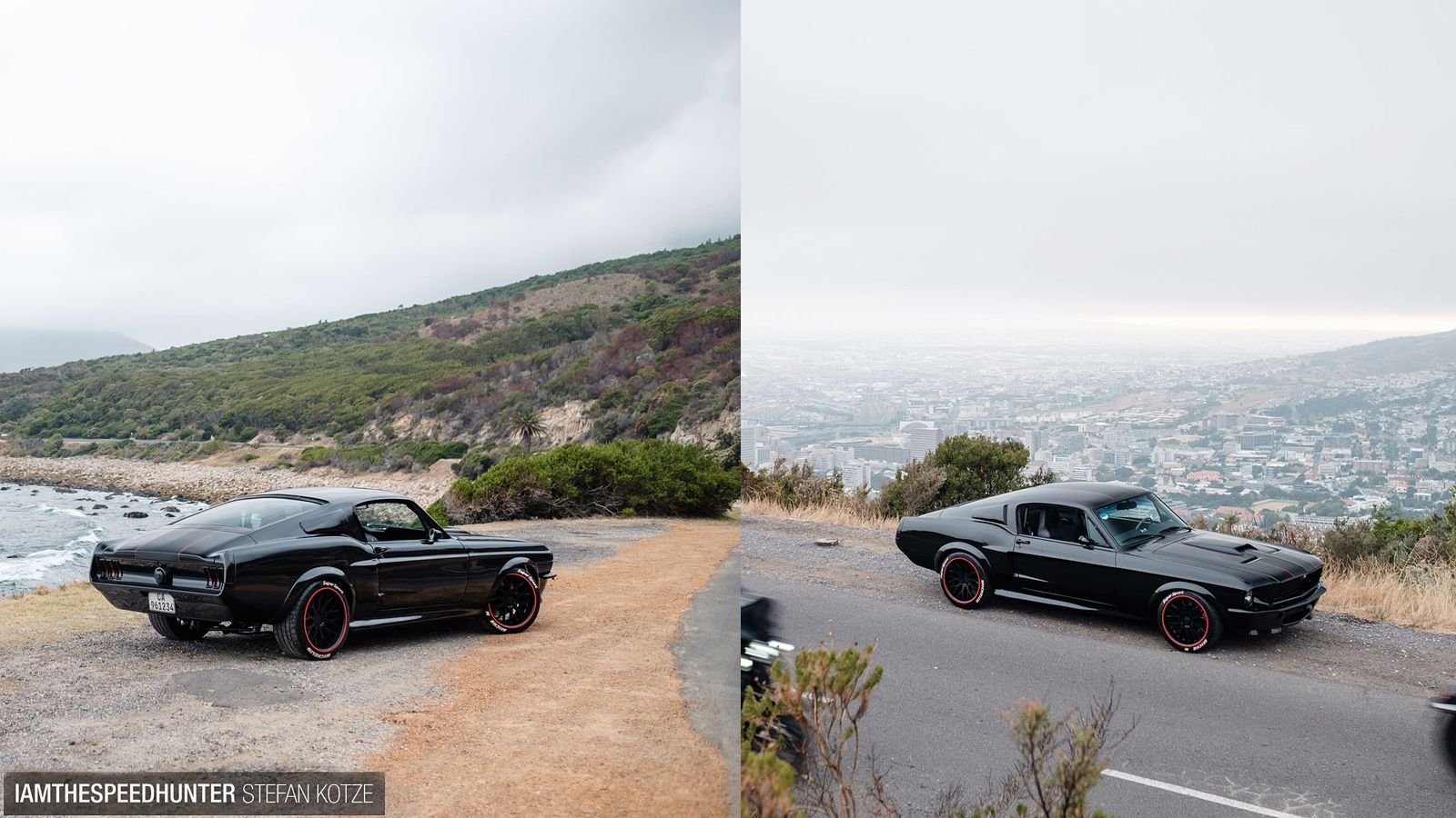

Every car person has a dream car. A car they design in their heads, checking imaginary boxes and arranging every detail the way they want it. When South African Laurent Decalion dreamed about his perfect Mustang, a 1968 Fastback, he dreamed out loud to his buddy Chad from the speed shop Sportech. Dreams turned to plans and details were plotted out over the course of the next year. Chad, predictably, cast his vote for power, handling, and braking ability—all reasonable goals—but first, they needed to find a suitable Mustang thousands of miles from the place of its birth. They found a car in Cape Town, one that had been rebuilt (but not well), looked okay, and went just okay. It was then time to get down to business.
>>Join the conversation on this Fire-Breathing Fastback right here in the Mustang Source Forum.
The Darkness
When they got the car back to Sportech and tore it down, 'okay' revealed itself to be 'not so okay.' Stripping the body and chassis to bare metal, they found corrosion, buckets of body filler, and uneven panel gaps. Some panels were replaced and others were repaired with metal patches, and the whole car was seam welded for additional strength. The new piano black paint is striking, all the more so because of the tasteful wide matte black and thin red striping. The completely blacked-out chrome works so well with the paint scheme it's easy to miss at first glance.

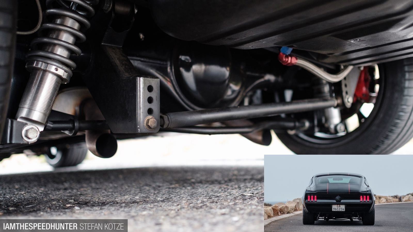

After some serious research, Laurent and Chad decided a full Heidts system was the way to go with the suspension. Up front that meant cutting out the shock towers and welding in the new set-up, which features fully adjustable coilovers, custom upper and lower control arms, a beefy sway bar, and polyurethane bushings wherever possible. The rear suspension also utilizes coilovers, mounted to a limited-slip 9-inch rear end. Six-piston caliper Wilwood brakes were fitted, along with a Wilwood master cylinder augmented by an electronic brake booster. The system works well when cold and offers modern braking performance.
