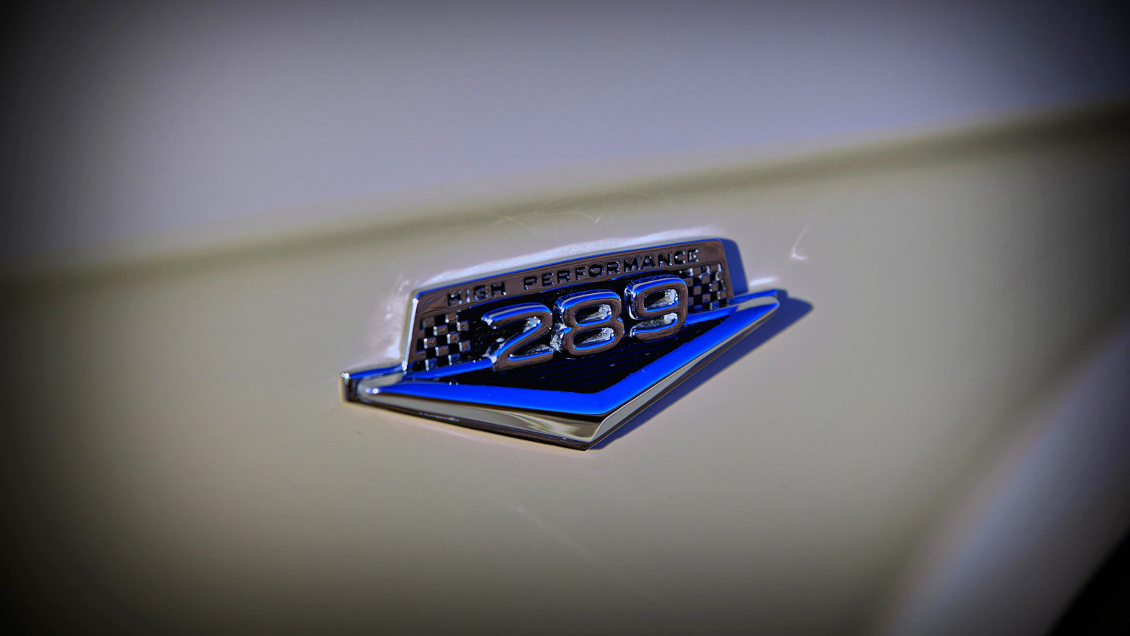

Original 289-CID Engine
Upon doing some research on the car’s VIN, the father and son found that the Mustang had the date code-correct 289 engine. This was a good thing because it meant that the prior owners had not tinkered much with the car; if it had already been customized to some extent, it would have made any further modification a bit more complex. Tom and his son also discovered that the Mustang was a genuine C-code car. C-code cars were special premium cars that had a 4-speed transmission, a power steering, power brakes, and AC pre-installed by Ford. This made it easier for Tom and his son to find the correct parts that would fit their project car and that is where their customization started.

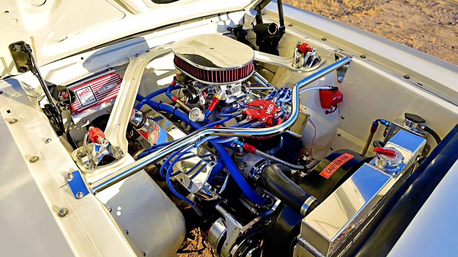

The Engine Customization
Tom used the 289 already in the Mustang and sent it for an overhaul. The reinvigorated engine received a 0.60 bore so the pistons could move in freedom. Other important parts such as the rotating assembly were made squeaky clean with polish and put back together using ARP hardware components. To enhance the engine even further, Tom went with big springs and valves from the dependable Summit racing which were installed together with 1.6:1 roller rockers inside the factory iron heads. All this mumbo-jumbo resulted in a highly impressive compression ratio of 9.0:1. And that’s for a half-century old car.
Furthermore, a flat tappet camshaft, a Parker single-plane air intake system and an Edelbrock carburetor setup were installed to increase the engine’s power delivery in demanding conditions. Other parts from Summit racing were also added like their commendable fuel pump that expels 80 gallons of fuel in an hour of operation. The engine then came to life with the help of an MSD ignition setup, which veteran Tom tuned himself.

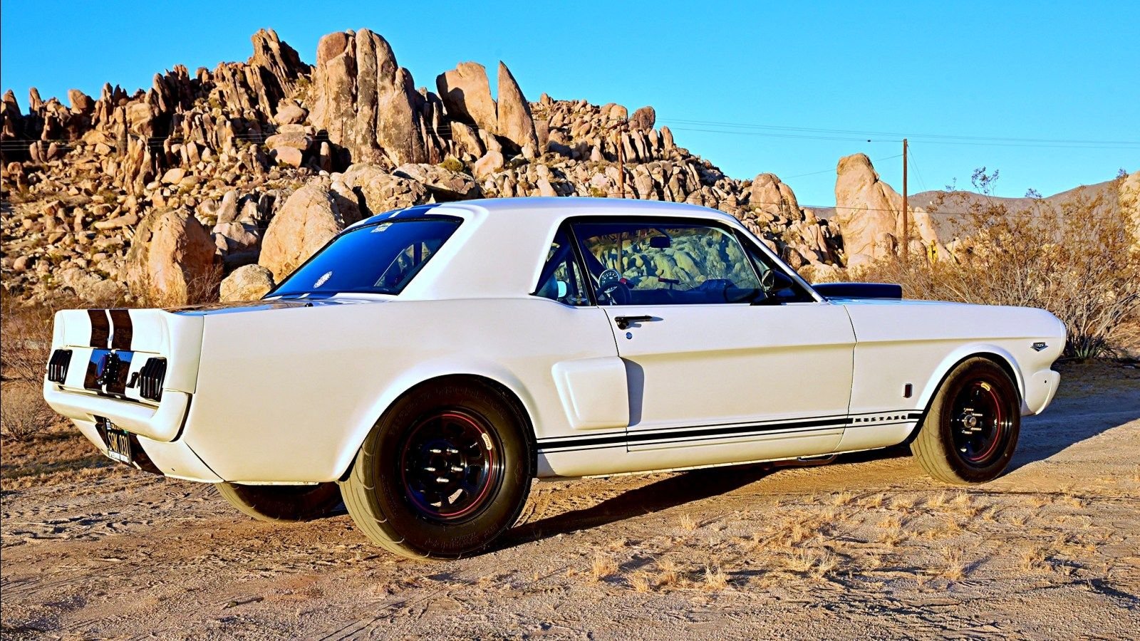

Family Friendly Mustang
However, that wasn’t all that Tom had in mind. He had moved to Southern California to be near his family and friends, so he made his car family friendly. Sort of a two-faceted machine that could rip off the tarmac and at the same time be able to cruise pleasantly with children inside. Tom chose the car probably because it is lightweight, sporty and it can be customized effortlessly. With the '66 Mustang, he was able to keep safety his prime concern while playing around with the engine. The car took Tom and his son Daniel two hardworking years to complete and in the end, the result was what many would call a dream car. The ’66 Mustang shone in its Wimbledon White paint job like a newly-wed bride.
