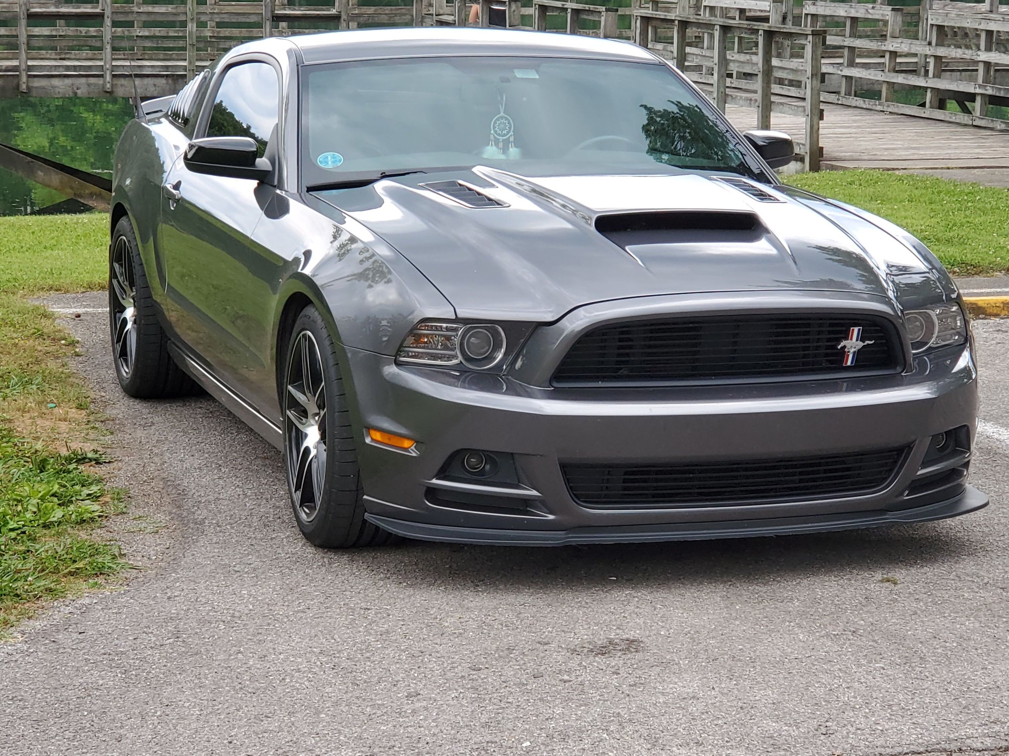

My solution was a Cervinis hood. https://cimg5.ibsrv.net/gimg/themust...86f7d0664e.jpg |

My solution was a Cervinis hood. https://cimg5.ibsrv.net/gimg/themust...86f7d0664e.jpg Maybe worth asking your dealer about the official TSB that went out a couple years ago about the hoods to see if they'll help you at all, |
(Post 7065853)
I also used the same solution - Cervini's hood. Great value for the dollar, color match was perfect and I've had mine on for over 50,000 miles and five years and it still looks great.
