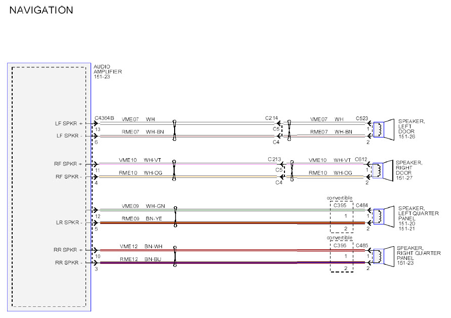

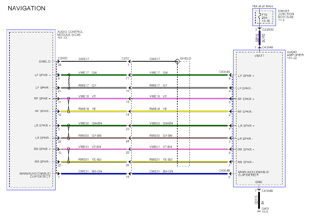

Here is the wiring diagram:
https://themustangsource.com/attachm...-oem-nav-2.jpg

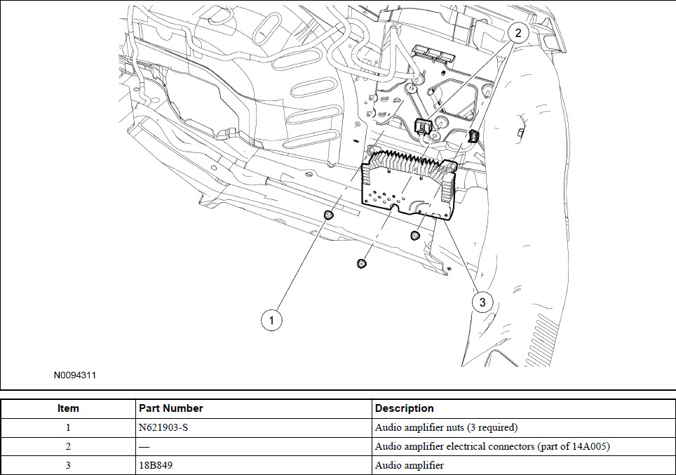

The OEM amp is located in the trunk. It is not the same amp or bracket as the Shaker1000, by the way.
https://themustangsource.com/attachm...-nav-photo.jpg
Attachment 216288

hawkeye18 Dec 30, 2012 03:03 PM
If you want, you can use my VIN - it's a 2012 with every option, including both the camera and backup sensors.
1ZVBP8CF2C5202331
hawkeye18 Jan 4, 2013 02:31 PM
2 Attachment(s)
Attachment 216276
Attachment 216277
That's a better picture of the wiring diagrams for the amp.
jim010 Jan 4, 2013 03:21 PM
That works better than my crummy photo.
Thanks, Hawkeye.
