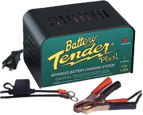

Here is what I use with the Cigarette Lighter Adapter
https://cimg9.ibsrv.net/gimg/themust...f05195a7ef.jpg
