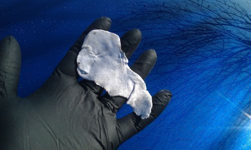

Yes, you should always clay bar the car before you wax it or polish it. What happens is you get all sorts of contaminants on your car while it is sitting outside at work or when you ran to take it to the grocery store or if it is sitting in your garage. When you wash it, not all of these will come off of your paint. So you have these tiny little particles that sit not your paint and you grab your Polisher and polishing compound and you put it on the car and go ahead and polish the car. Well, what you actually do is take these fine little particles and drive them into the paint of your car causing micro marring and tiny little scratches. Even if you skip the polishing process and go straight to waxing it, you have the same issue. When you clay bar the car, you are removing these surface contaminates so you ensure that your car's paint is completely clean and ready for the correction process.
https://cimg1.ibsrv.net/gimg/themust...87fc017dff.jpg
