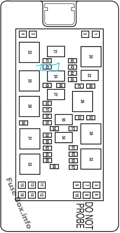

A small request. Could someone please do me a favor? After driving your 05-09 Mustang, pop the hood and remove fuse 43 (circled in Pic). When you do, do you hear a faint clicking sound? Then place it back in and remove it again. Does the sound repeat? Trying to track down a drain issue and want to know if other Mustangs do this.
I am well aware of everything that draws power from the battery. I don't need tips on how to do a battery test or suggestions to change my radio.
I just need someone to help me out and perform what I am asking. Thank you.

Tried This A.M. But My Battery Was Dead So I Slow Charged it and Got Er Started and Let Run For 1/2 an Hour To Charge & Let Fluids Circulate. No Noise and No Spark at Fuse. I would Think if That Fuse Had a Draw You Could Maybe See and Hear a Bit of a Spark Noise Right At Fuse Block!
Also Got Sidetracked For an Hour or So Chasing a Wayward Poodle For a Mile or So Through a Walnut & Then Almond Field on My Very Slow Lawn Tractor! Wife Corraled Her in The Harley Truck at the Other End By Sheer Luck or Divine Intervention. Neither of Us Had Ever Been Down Either Location! Poodle Managed To Stop traffic on our Two Lane Highway in Front of Our House Average Speed 60Mph For The Cars! Aye Carumba! The Poodle Was Being Chased By The Dogs Groomer Who The Poodle Got away From! Oh And The Groomer Also Had One of Her Own Poodles Get Loose and And I Caught Her By Sheer Luck as Well Not Knowing At the Time Another Dog Was Loose! Anyhoo Did My Good Deed For The Day!
Be Advised A Gt-500 Does Have a Bit Different Setup But Gave it a Go!

Thank you very much KC for checking your car. So yours doesn't make any faint clicking noise when pulling fuse 43? Humm I'm suspicious that my alt is drawing power when car is off which would explain my dead battery if I let the car sit for a day but I'll need more data. I really hope someone else will be kind enough to check and help out.
And thanks for encouraging other to help. You wouldn't believe the amount of replies I got over on FB. Everything from "tips" to "bro change your radio" yet NO one would take 2 seconds to help and check thier car. Same here 95 reads and only you cared to help/reply... So much for "community" haha. I just find it astonishing.

Finally got around to checking mine... At any rate, no clicking noises on my end... But also keep in mind that my battery is always fully charged, as I keep a battery tender connected whenever my car is not being operated...

One thing you can check is hooking an ammeter in series to your battery and see what the current draw is with everything off. then pull #43 and see if anything changes. If memory serves, anything more than 50mA means you've got parasitic drain.

Thank you @m05fastbackGT for checking. I really appreciate it. Just as long as you ran the car before removing the fuse and heard nothing then that would be perfect.

Thank you for you@Cavero and for checking your car. Yup its the alternator fuse. I have a 2010 Denso alt (referbed) and I am thinking it might be the issue or ONE of the issues to my problem. I also changed the radio to the Dynavin. Over the last summer I have done a few battery tests and came to the conclusion that the power that is being drawn after the car is asleep is the radio circut, the alt circut and the starter circut. The thing is these all change when I test and retest the car on different days so I am trying to track down what it might be since its different all the time but the radio and alt circut seems to be consistent. When I dont drive the car I remove these 3 fuses and the car seems to last more than a day but after say 3 or 4 days the battery is dead, but if I keep those fuses plugged in, its dead in a day. I start with the multimeter in series with the battery then let the car go to sleep.

Just a small update. Has some time to look at the car today. Found out that the clicking noise when I pull fuse 43 is coming form the EPAS. Though it's weird cause when I pulled the data connector the same clicking noise happened. It's definitely the alternator fuse goes from 0.257 to 0.050 amps.. As pulling the radio fuse after the car sleeps does nothing. The diagnosis continues.

So I checked the ground. Even moved to another one and it's the same thing. Also found out that the battery drain is coming from the EPAS. Whether it's the data line or the power line. Same results. So I'm going to figure out how to put a relay in line get a new battery cause this one is toast and call it a day.
