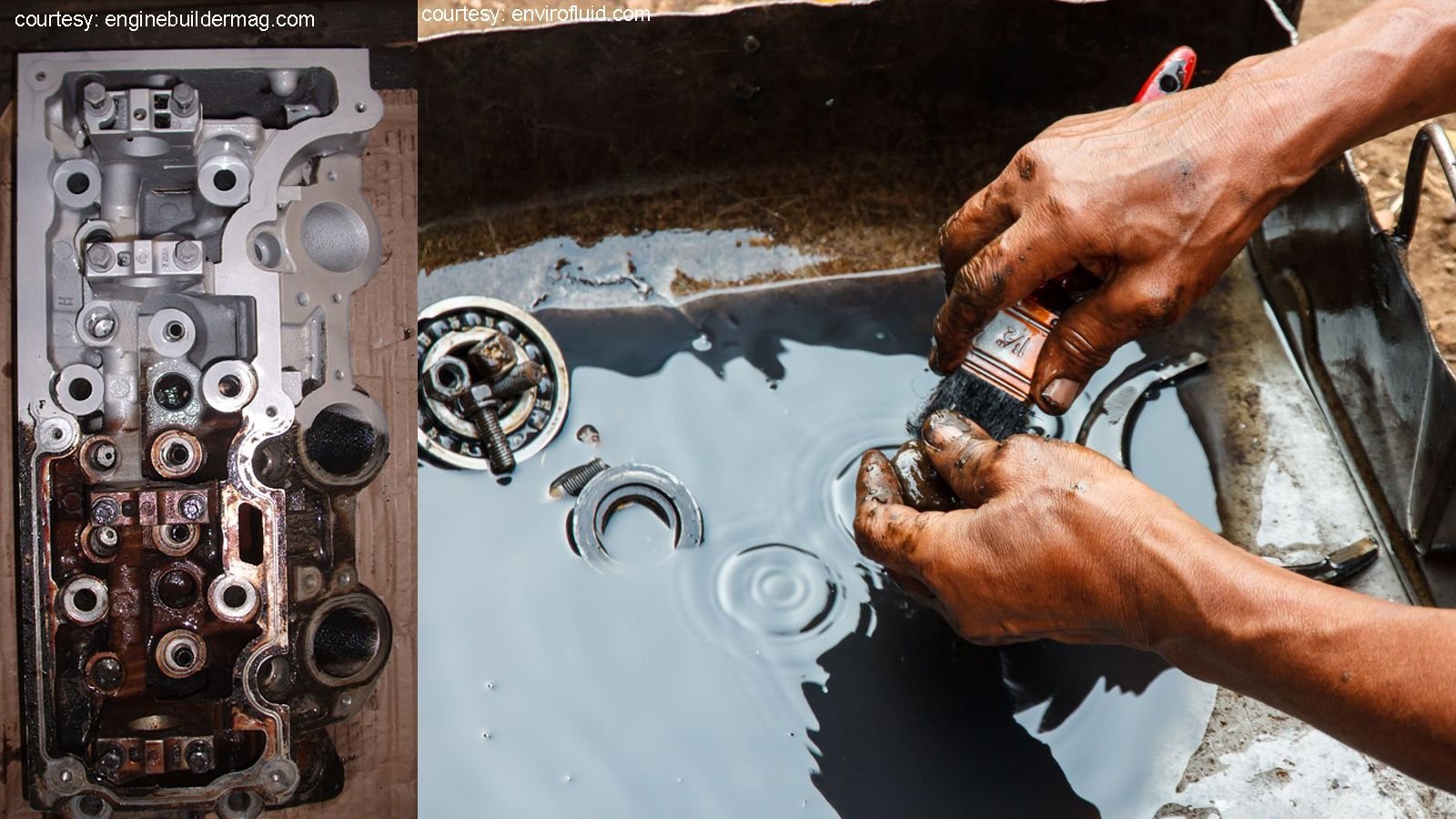

2. Clean It
If there is one rule that trumps them all this is it... also. It helps if you think of a dirty part as being broken, and the first step in fixing it is removing the contamination. Don't even take anything apart until you pre-clean it. Dirt gets everywhere, remove as much of it as you can at every step, and all of it before you assemble anything. Even your friendly neighborhood Speedy Lube workers at least wipe off drain plugs before sticking a socket on them (or we imagine they do, we didn't really verify this). Cleaner sockets and cleaner fingernails are a pleasant benefit of working with spotless parts, but there are stronger arguments for the spic-and-span treatment, not the least of which is that you can see them better, which brings us to our next rule...

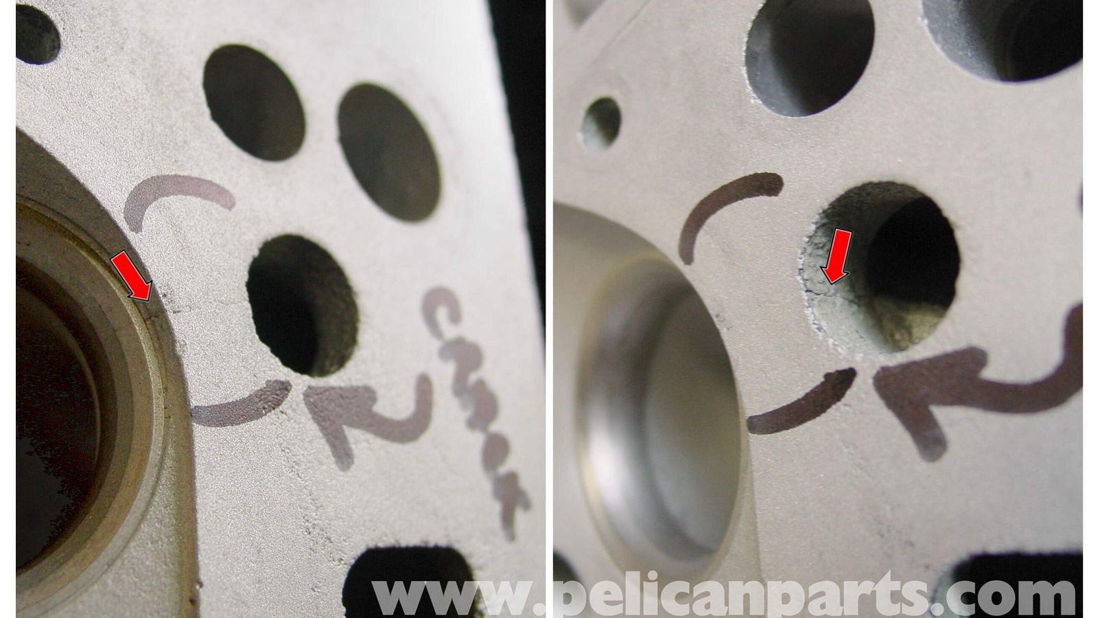

3. Inspect It
Like that joke about the psychologist with the punchline "I can clearly see you're nuts," you can clearly see your parts once they are clean. Even if you plan to replace them, it's illuminating to closely inspect the used ones for signs of wear or failure. In fact, wear patterns will tell you not only if an individual piece is a garbage, but how assemblies are working together. Taking a good hard look can often catch problems before they bloom into catastrophes. Parts also need to be cleaned before they can be magnafluxed or dye-checked for cracks. Even modern shops aren't known for being the brightest places on earth so make sure you use additional lighting when checking items and using magnification isn't a bad idea either. Every part has a weak spot where it's most likely to fail, with experience your attention will be drawn to those areas. Be suspicious, every part has to prove to you it hasn't been compromised.

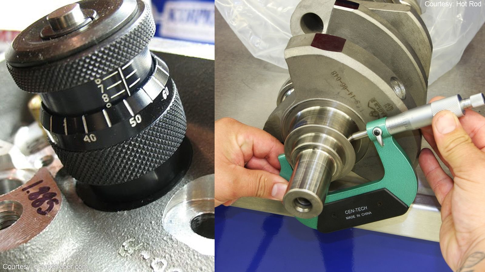

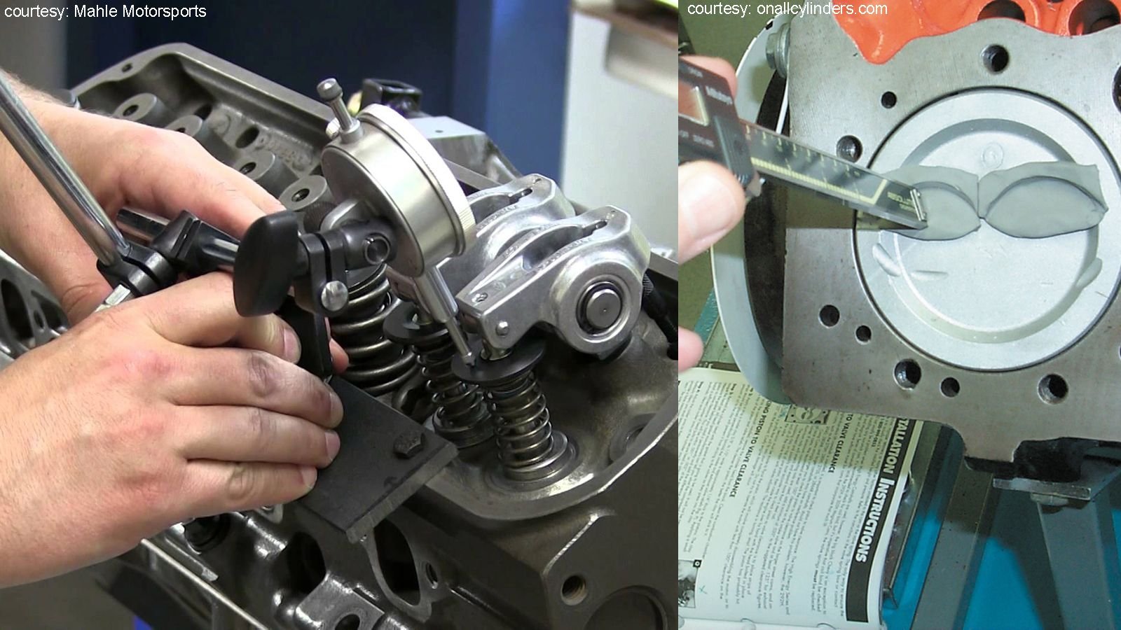

4. Measure It
Clean, undamaged parts aren't ready for reassembly just yet, they have to be measured—and that goes for new parts too. Often you can tell if something fits or not by feel alone (see rule #1) but at some point, you're going to have to measure it. You'll need some specialized measuring tools for this step. Some are relatively inexpensive and simple (feeler gauges, calipers, plastigauge), while others are a little more pricey and delicate (micrometers, dial indicators, etc). You'll save yourself a lot of heartaches if you measure everything before it goes together. Even things as simple as thread pitch or bolt shank length has snuck up and bit the unsuspecting technician in the butt. Don't get bit by a bolt—measure.

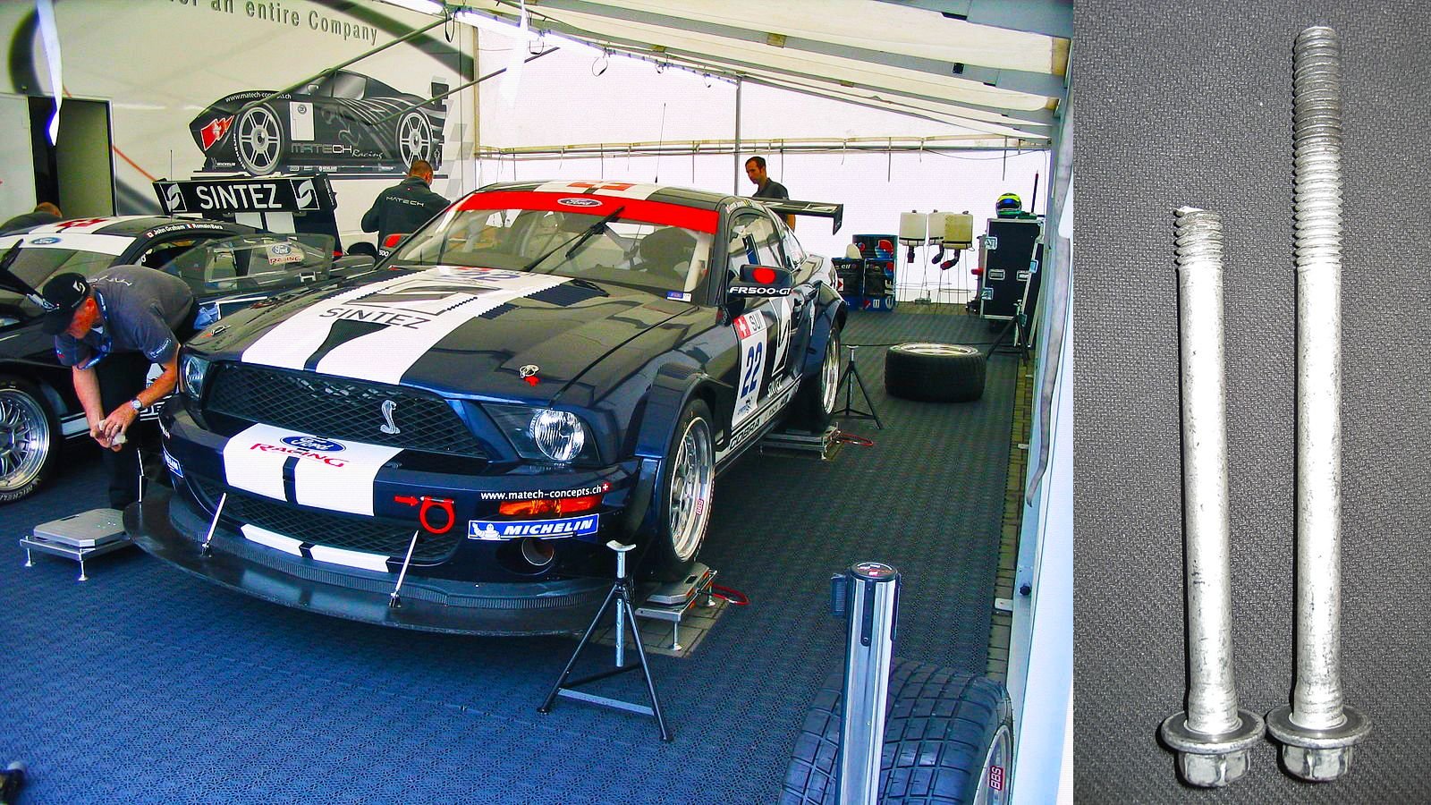

5. Test Assemble It
How can you tell if something will work correctly when it's all put together? Simple: put it together. But not for real. Not with sealant and full lubrication, and especially not with the even hint of an idea that it's for the last time. Test assembly is, in effect, measuring how all the pretty parts you measured from Rule #4 fit together. Do they clear? Do they turn? Do they do what they were designed to do? Making your car goes, turn, and stop is the job of all those pieces. Think of yourself as their H.R. manager—you have to make sure every member of the team fits and can do the job you recruited them for. Sometimes you have to fire somebody, sometimes you have to send them off for sensitivity training, but in the end, you'll sleep better when you know every member of the team is pulling their weight.
